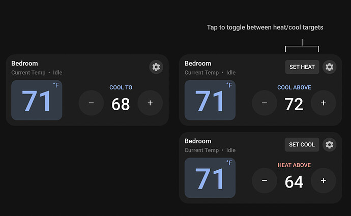

Ok here is where I’m at right now:
Top (blue) default layout for people who don’t use Ranges.
2nd Red has ranges clearly set with current temp. Current Temp would turn blue if above 72 I was thinking.
To change ranges you tap the edit ranges button in the bottom right which would bring a second screen up to edit both heat and cool range settings. User would need to “update” them in order to save them. Panel would close on save or you hit the X in the top right.
I guess I still need to add in humidity range selector, but I’m getting there I think.
Hows this all looking?

Ok here is what I got so far for all the settings.
Second set on the right has an extra button on the main interface that you can tap and toggle between setting heating / cooling targets.
