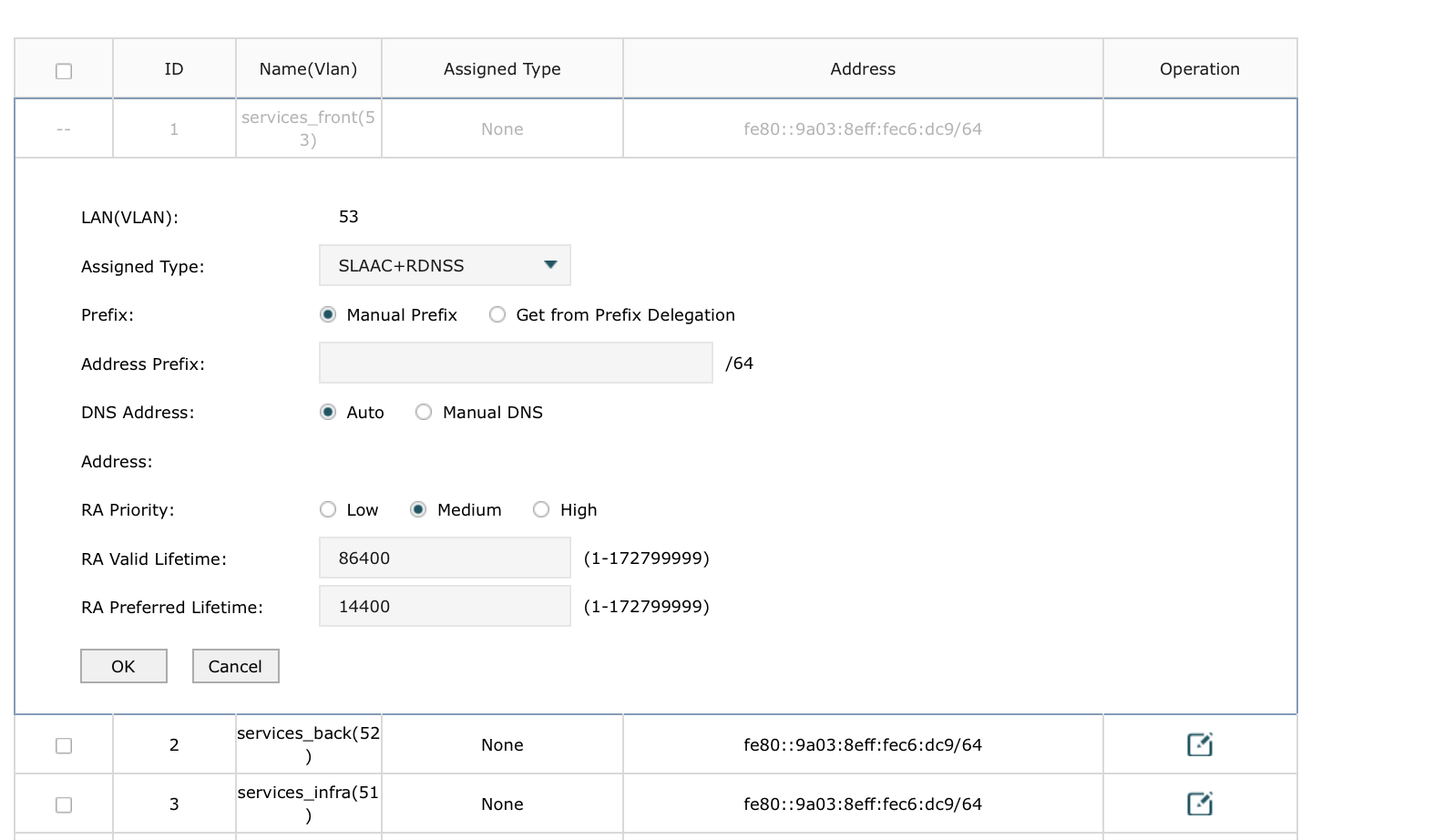

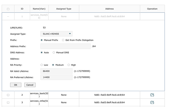

Now: as you probably read, my setup is a tad complex. I have as a router a TP-Link ER605 which supports IPv6 routing but not static IPv6 routes (mentioning this because I’ve read elsewhere that this may be a problem, hopefully not).

My IPv6 VLANs are configured as follows:
ipv6 vlan
VLAN name(VLAN ID) Type Router address
services_front(53) SLAAC+RDNSS 2001:ca51:7a53:0:9a03:8eff:fec6:dc9/64
services_back(52) SLAAC+RDNSS 2001:ca51:7a52:0:9a03:8eff:fec6:dc9/64
management(19) SLAAC+RDNSS 2001:ca51:7a19:0:9a03:8eff:fec6:dc9/64
wifinetwork(20) SLAAC+RDNSS 2001:ca51:7a20:0:9a03:8eff:fec6:dc9/64
Finally, some screenshots of my HA instance during the pairing (I clicked those credentials buttons a decillion times in all possible combinations, I think):
If you have any idea, I am all ears. I’ve exhausted all my luck with online threads and I even wrote to a few AI agents all these insights. No luck either.
Thank you so much in advance! I hope to hear back from you guys!

You will need a “routable” IPv6 address prefix on the one VLAN that HA/Matter/OTBR live on in order for the OTBR to route from/to that VLAN to/from your Thread devices. Link Locals are not routable addresses. In general, the OTBR should be creating such a routable prefix if it doesn’t see one and sends it out using RAs, but somehow your OTBR’s eth0 doesn’t have a routable prefix. Just curious… but how did you configured the OTBR’s eth0 to only use link local?
I’m sorry – I have no experience with IPv6, not to mention HA, OTBR, Thread, Matter and all these network solutions… I must confess that I am quite lost with your comment. Let me see if I can give you an answer to what I understand you are asking me.
I didn’t configure it to only use link-local, it just ended up that way. My ER605 doesn’t support ULA prefixes on the LAN side (it only does ISP-delegated prefixes).
I think, as you can see below, in the absence of a global unicast address (which I removed following @WallyR 's advice) the fe80:: LLA is used, and since my podman-compose explicitly sets en0 to be the interface used by otbr, it ends up using that LLA? Notice the /64 for the prefix is hardcoded and ULA prefixes have /48, as far as my Google skills tell me.
As a final comment: my switches and router have IGMP Snooping enabled. I’ve read elsewhere that it may be a problem, but since every device now rests in the same network I do not see how that may conflict. No ACLs (specially for IPv6) are active at the moment. And also, mDNS multicast is enabled for every VLAN.
I would appreciate further input. As I mentioned: I am quite lost here. Thanks once again @wmaker @WallyR :pray:
So link local addresses (the FE80 addresses) are “scoped” to not go beyond the " link" (link here means VLAN), so these can not be used for routing. The OTBR is an IPv6 router, which means it can only route IPv6 network address that has a scope beyond the link (VLAN). A GUA (global like “2001”) or ULA (unique) are typical types of addresses that are scoped beyond the link and the types the OTBR needs for routing. So the VLAN that HA/OTBR/Matter are attached to need to have a routable (GUA/ULA) prefix/address.
Anyway, one of the issues I see is that the OTBR tries to ensure that the (V)LAN it is attached to has a routable IPv6 prefix. So if it doesn’t see any other router advertising a routable prefix, the OTBR is suppose to pick one and send it out using Router Advertisements and other IPv6 hosts on the same VLAN are suppose to use this prefix. After you turned off the 2001 addresses being advertised by your ER605, the OTBR was suppose to pick a ULA prefix and use it for RAs as well as assign itself an address using that prefix. I don’t see this happening.
Let me also add that pulling in a Docker OTBR that is not a derivative of the one used by HA can make things harder too. I have seen others instead use the Ownbee one (although I haven’t used it myself).
You are still not handling the multicast routing.
Multicast cant be routed with normal IP routing. It is not meant to be, so you need other features or hardware to handle that.
So I finally managed to get this working.

Important things that I’ve learned:
  1. I had a bunch of problems for trying to split the network of otbr and matter-server. They could reach each other always, but after inspecting IPv6 UDP packets with tcpdump, the packets were having some strange UDP checksum problems. Make sure to make the network of one or another be shared with the other container.
  2. Thanks to @WallyR I understood the multicast routing problem. While Googling (and talking to some AI agents) I learned that radvd existed and is now acting as my prefix router (if that’s the correct terminology, I am now getting into IPv6 networking :slight_smile: ).
  3. All my devices, from the Thread RPC to the end device initing the commissioning, are now on the same VLAN.
I want to try removing 2) and 3), but this is probably my final post.
Thanks for your help @wmaker @WallyR , I appreciate the time and effort :pray:
P.S.: If you have any comments about my words, let me know. It is possible that I am overcomplicating things here or that some of the things I said are not entirely accurate.
Just a minor comment, radvd is a Router Advertisement daemon which is used to send out Router Advertisements (RAs) and these RAs is what I mentioned earlier was missing from your OTBR. Nevertheless what you have done should work but if your goal is “removing 2)” then maybe removed the radvd and see if you can get the OTBR to send the RAs instead.
As for “removing 3)”, no keep all of this on the same VLAN.
Also, terminology-wise, RAs are not for multicast routing (whereas PIMv6 is), but RAs do use link-local multicast for their destination address and these are link-local multicast addresses.
Just to clarify, did you actually get a Matter/Thread device commissioned?
As I see it only works due to 3.
You have still not managed the multicast between the VLANs, so you can probably not get it to work in a setup with parts in different VLANs.
