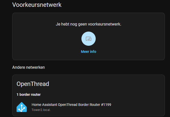

Running OTBR in Docker
I’m trying to rung OTBR in Docker so it can work with a SLZB-07Mg24 USB stick.
Running the following command to launch OTBR:
$ docker run -it --rm \
    --sysctl "net.ipv6.conf.all.disable_ipv6=0 net.ipv4.conf.all.forwarding=1 net.ipv6.conf.all.forwarding=1" \
    -p 8080:8080 \
    -p 80:8888 \
    --dns=127.0.0.1 \
    --volume /dev/serial/by-id/usb-SMLIGHT_SMLIGHT_SLZB-07Mg24_6add7a39f772ed118f6073773dbf42d5-if00-port0:/dev/ttyMyStick \
    --privileged \
    openthread/otbr --radio-url spinel+hdlc+uart:///dev/ttyMyStick
Used the command to determine the USB device:
$ ls -la /dev/serial/by-id/usb-*
lrwxrwxrwx 1 root root 13 Jan 24 04:53 /dev/serial/by-id/usb-SMLIGHT_SMLIGHT_SLZB-07Mg24_6add7a39f772ed118f6073773dbf42d5-if00-port0 -> ../../ttyUSB0
The output from OTBR is:
WARNING: Localhost DNS setting (--dns=127.0.0.1) may fail in containers.
RADIO_URL: spinel+hdlc+uart:///dev/ttyMyStick

Iam a little further.
I was able to flash the connect ZBT-2 with Thread.
HA is the network seeing:
I’m only not able to get it as preffered network.
My Docker:

The log says:
:00:36.210 [I] Mle-----------: AttachState Announce → Idle
00:00:36.211 [I] BbrLocal------: Remove BBR Service: seqno (36), delay (5s), timeout (3600s), NotFound
00:00:36.211 [I] Mle-----------: AttachState Idle → Start
00:00:36.211 [N] Mle-----------: Attach attempt 6 unsuccessful, will try again in 8.046 seconds
What to do to get it preffered network?
You can’t set it as the preferred network until HA has learned the credentials. We can tell the credentials aren’t known because there is no circled-i (i) icon beside the network name. With OTBR, there are a few ways to fix this.
The most common is to add the OTBR integration, which usually happens automatically but can also be added manually using the Thread Integration’s “Add an OpenThread Border router” menu (top right) and enter the REST API URL (I believe localhost:8081 for HAOS).
Alternatively you could open the OTBR dashboard (homeassistant.local:8080) to view and extract the dataset TLV and enter it manually in the Thread integration’s “Add dataset from TLV” menu (top right). But this method does not enable the “reset border router” or “change channel” commands like the above method does.
