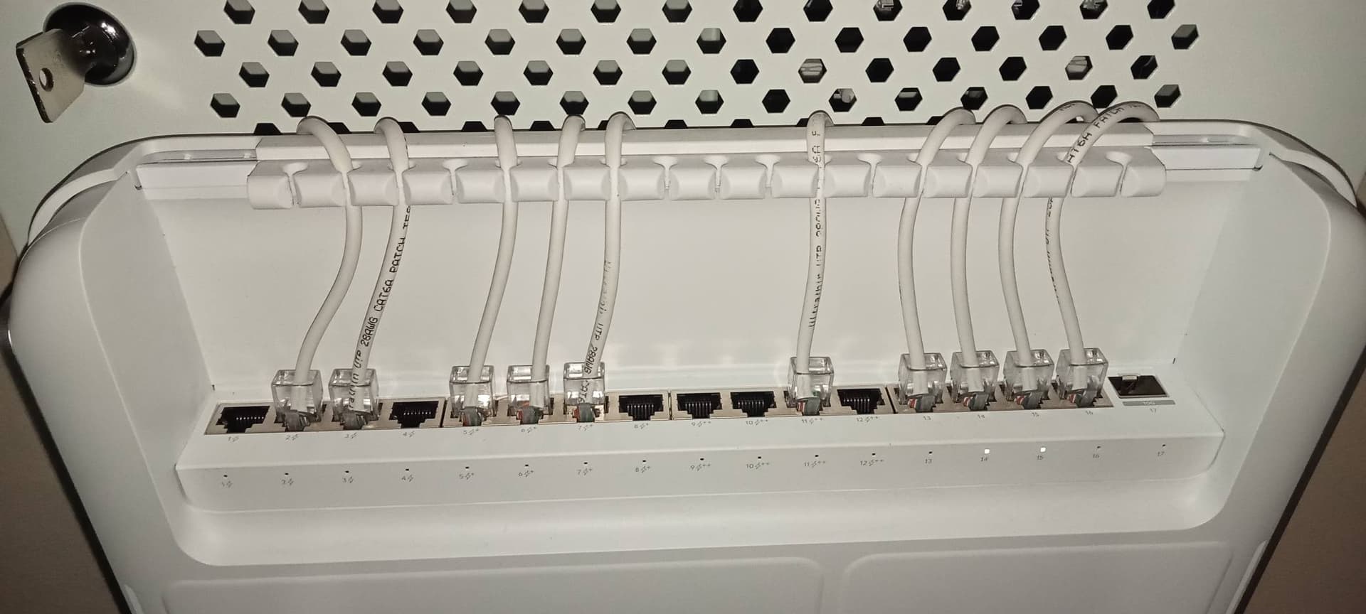

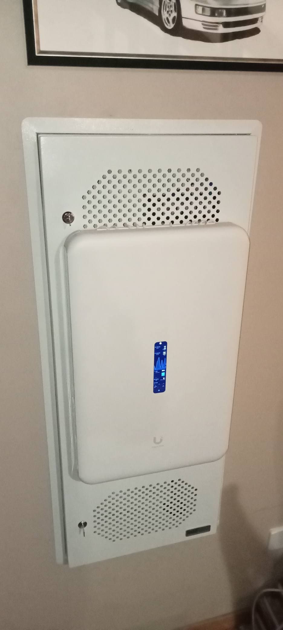

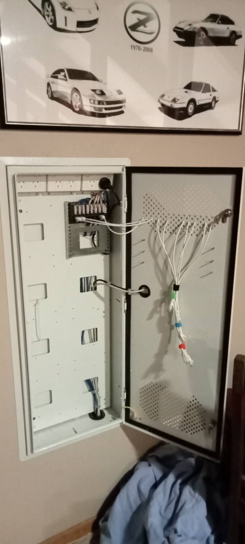

You will need a decent Wifi and Zigbee backbone. Consider where you may want POE devices like Access Points, Zigbee Repeaters, Displays and Media Players. For POE you will require ethernet. I can highly recommend Unifi for ethernet network and the access points will handle multiple hundreds of devices connected, unlike a lot of consumer grade or ISP provided routers. A Unifi UDR is all you may need.
Wire all your switch plates to have a neutral wire, to increase compatibility with smart switches available.
Example below of Unifi deployment.
Example below of dashboard hardware.
