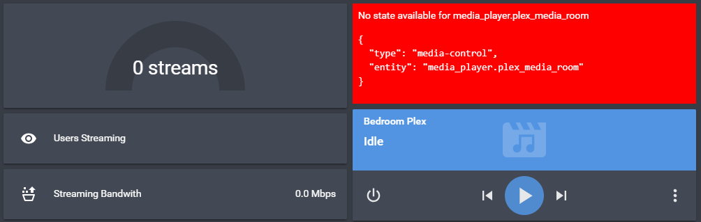

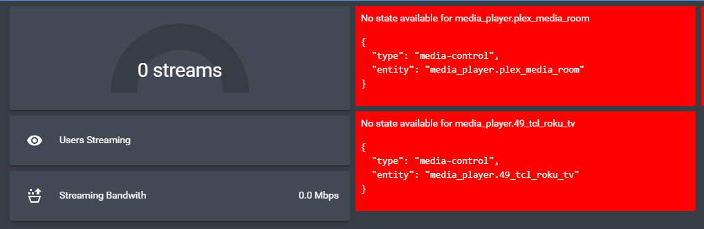

Is there a way to hide media players when they are not available in Lovelace? I am getting this error on my plex media players. When I restart Home Assistant, the media players for plex do not show up until I start streaming something to them. I understand why the card is not showing up (there is no entity called “media_player.plex_media_room” yet), but is there a way to hide it until the media player becomes available?
changes to this once something has been streamed to it
