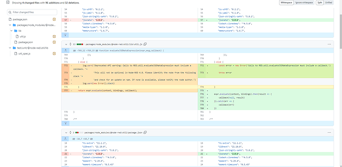

2: Anyone who applied the patch (see above) to pre-edit util.js on start up now needs to remove this patch, since the file has been modified, and continuing to remove the lines 772 to 775 will remove required code, leaving corrupt JavaScript.
You have been warned.
Please see the pre v4.0 on the left, and the v4.0 code on the right. You really do not want to be removing lines 772 to 775 anymore!
