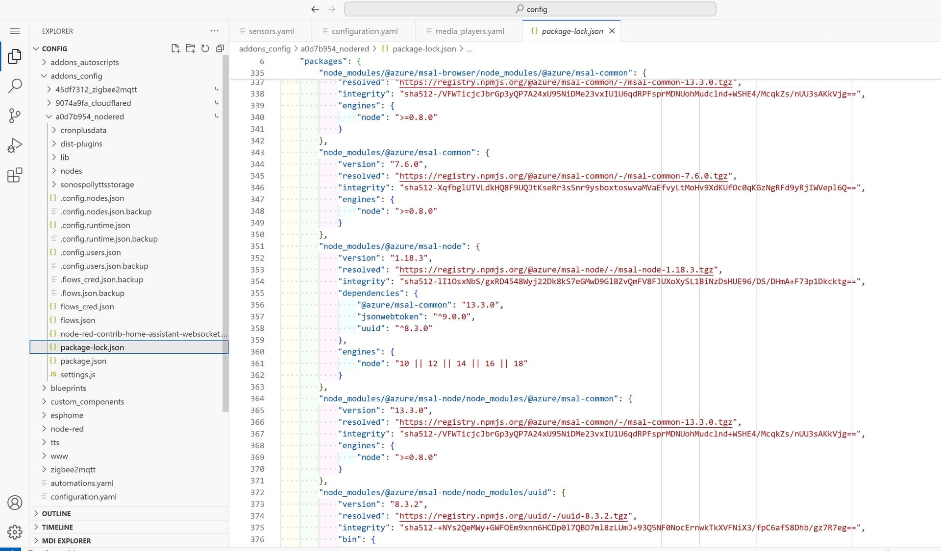

So, you must have @azure/msal-node installed in your node_modules directory, and this needs updating. I donât know but I think that this is not a contrib node but rather a support library that something else has ârequiredâ.
To find out what module depends on this (ie what got it into your node_modules directory in the first place) you need to run,from the .node-red user directory,
npm list
or
npm list @azure/msal-node
to list dependencies .
Fortunately it seems the NR as an add-on already runs in this directory, hence add an exec node to a flow (with inject and debug) and use the command as follows;
Then all you have to do is go through the result and look for @azure and see what depends on itâŚ

And, inside this is the package.json file
And, inside that is the line
"dependencies": {
"@azure/msal-node": "^1.0.1"
which is saying - I need @azure/msal-node, from version 1.0.1.
And, the ^
says âonly this major releaseâ, hence anything from 1.0.1 to 1.18.3 (which is probably the very last v1+ before v2 came in).
So, an answer for the brave is to edit this line to
^2.0.1
(which will bring in the last version in v2+ which should support node.js v22)
