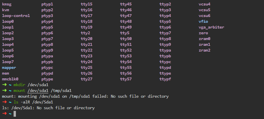

You don’t have an sda1, sd1b, or mmcblk0p1 config.txt. What are you using? Is this windows? When you put a terminal app into Disable Protection Mode, what is the result of ls /dev/?
Currently your system is not supported, but I’d like it to be.
If you can show me an instance of HassOS on x86 with an sda1 “boot” partition, I will support it.
@adamoutler are you asking me? I am using home assistant blue (ODroid N2). But as I said, once I killed power to my device and then restored power and started the machine back up, I was able to use the add-on again. I still dont have access on 22222, but ill just wait for repo to be updated.
Can you set your terminal addon to Disable Security, then run the following
ls /dev
mkdir /dev/sda1
mount /dev/sda1 /tmp/sda1
ls -alR /dev/sda1
I would like to see the output from the terminal. I can likely support your device with this.
