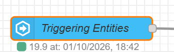

I’m getting the date in format month/day/year, which is incorrect for my location. The correct one is day-month-year, and the one preferred by me is year-month-day
I see no option to modify that in the server node (see screenshot).

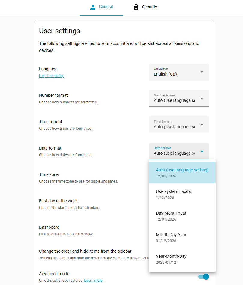

Home Assistant offers both timezone setting, and locale setting. Timezone is set once on installation, but can also be set/changed in the Settings > System > General, so for myself I have Europe/London.

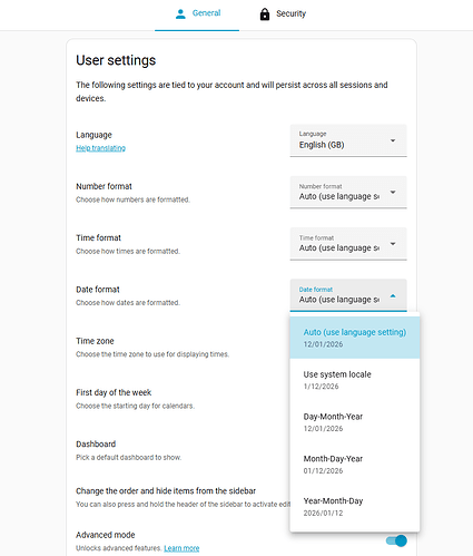

Locale settings are more complicated, and are set for each user. This is done via the user icon in the menu (bottom left), so it would appear that you can only set these for yourself and only when logged in.
So, for myself I have set the Language to English(GB) which probably drives the user locale as en-GB. The following number/time/date formats are then driven from this as ‘auto’ which uses the set locale, or something else from a pick-list.
You can see that the HA user locale date is auto (which is 12/01/2026 as I am set to en-GB) or system (which is 1/12/2026 since the system default is en-US). We also have day-month-year and month-day-year, and year-month-day.
All fine for Home Assistant.

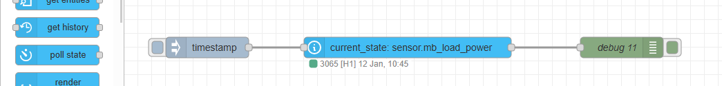

Looking at my HA Node-RED add-onJan 12

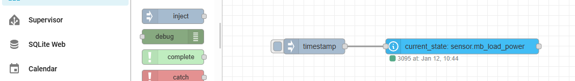

Looking at my Raspberry Pi Node-RED12 Jan
so yes, it is not working.

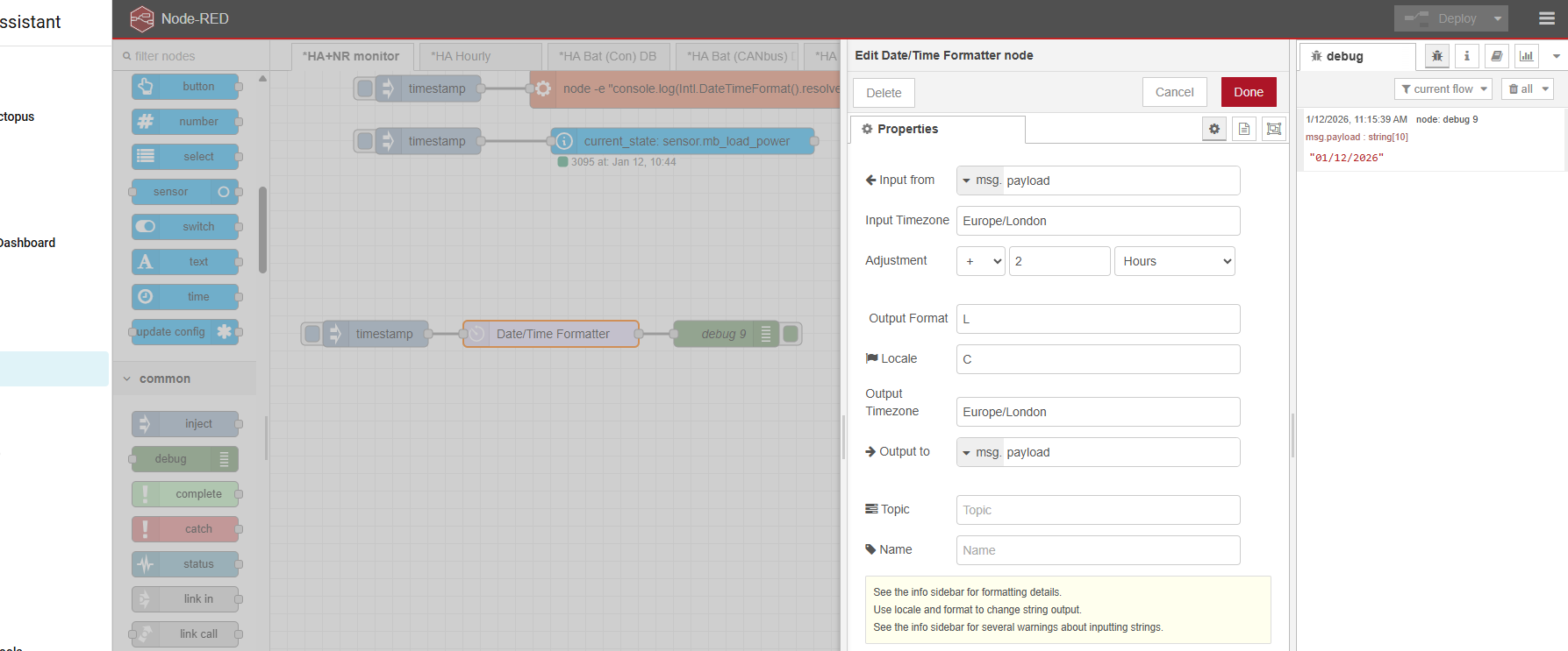

I have used the moment node (date time formatter) quite a lot, and the UI config defaults the timezones from the ‘system’, and offers locale formatting, by default as ‘C’ for local computer system.
A quick test shows that, although Node-RED add-on knows my timezone, the system locale is still stuck as the default en-US, and I have to set the locale manually in the node to en-GB to get the UK format.
