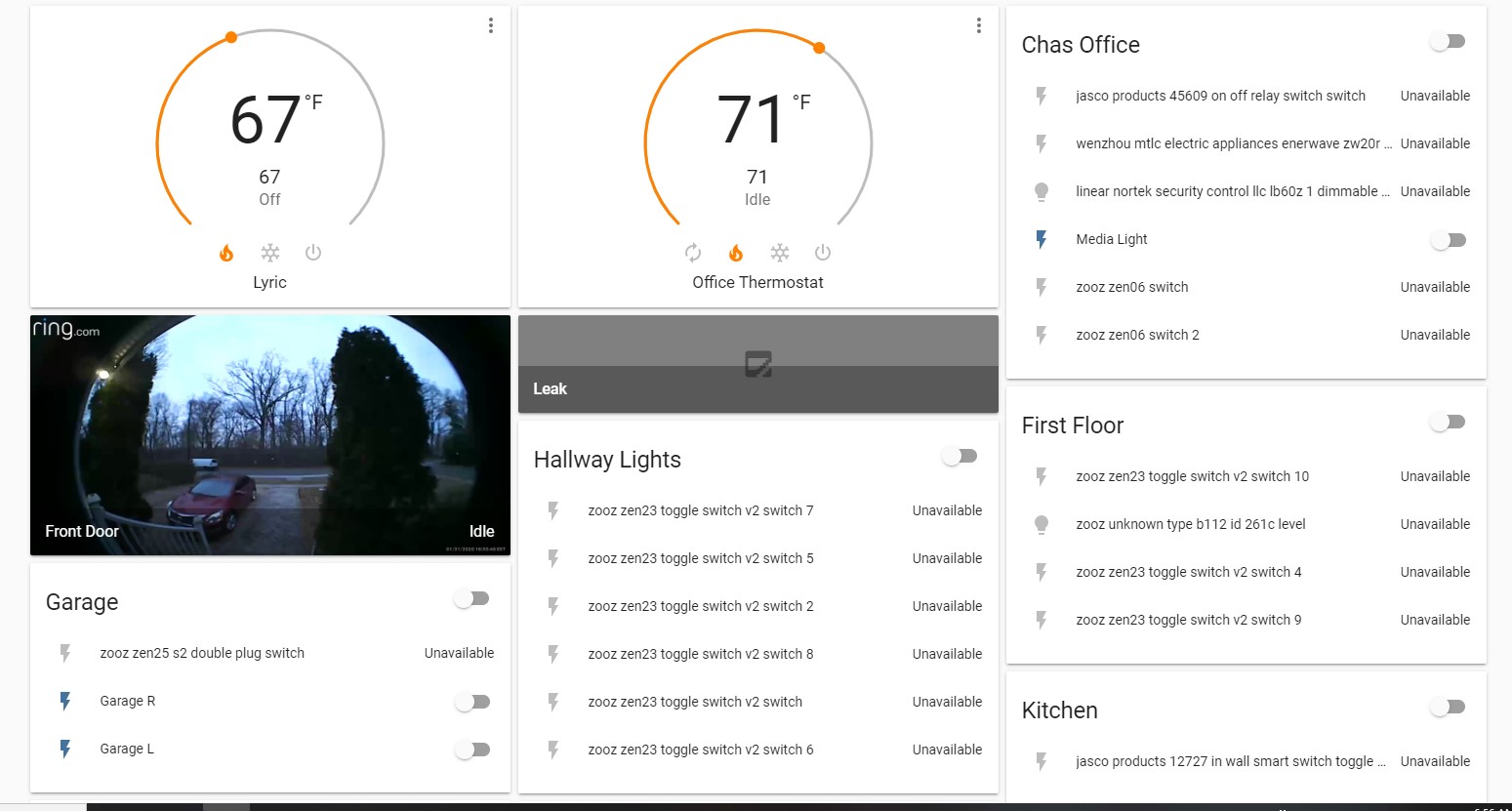

when I got up yesterday morning this is what my Home Assistant dashboard looked like. Running Dell R710 Unraid Version 6.8.2 2020-01-26.
I have been checking setting and restarting for a day but no improvement. I have checked and changed, then changed again the path to my Zwave stick (Currently; /dev/ttyACM0)
The odd thing is that if I go to zwave I have several devices that show complete.
Leviton DZMX1-1LZ Dimmer (Node:69 Complete)
and then many more that show ;Node:undefined undefined
zooz zen23 toggle switch v2 (Node:undefined undefined)
However all of the devices show Unavailable on the dashboard
I do not run Node-Red
Any help, direction and or suggestion appreciated.
