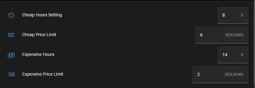

Here is a bit of extended code for aio energy management with cheap and expensive hours. There are some input helpers to be able to fine tune values that need to be created for this to work.
i found the expensive setting to be usefull if you don’t want to turn something off if the price is low enought the whole day.

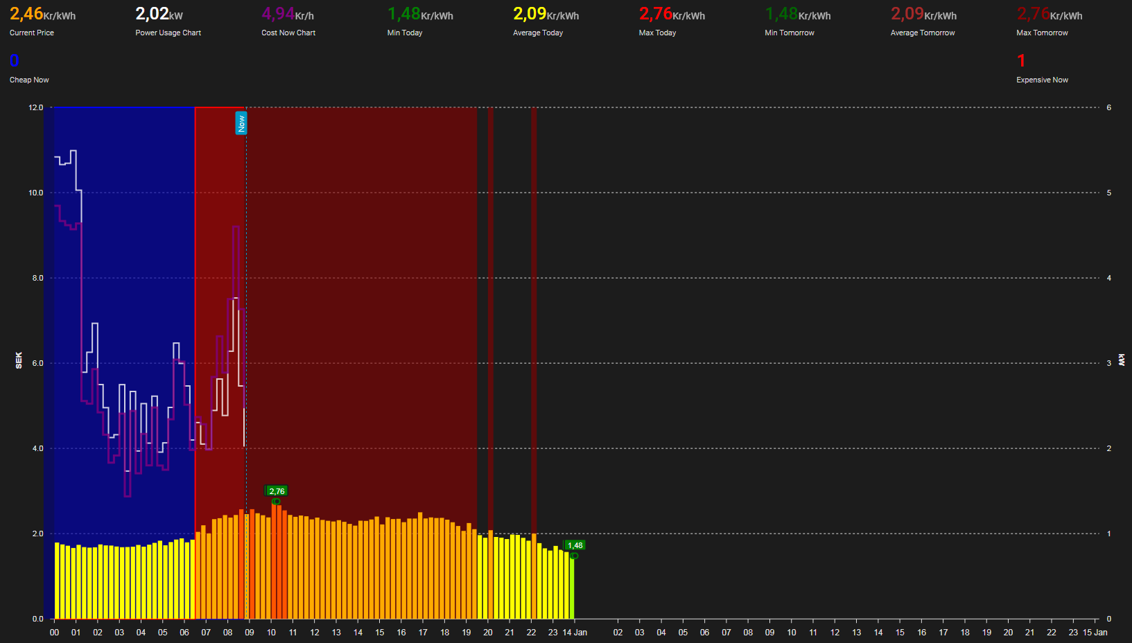

And graphs for that (and alot of extra stuff)
type: custom:apexcharts-card
experimental:
  color_threshold: true
apex_config:
  responsive:
    - breakpoint: 500
      options:
        chart:
          height: 300px
    - breakpoint: 1200
      options:
        chart:
          height: 640px
    - breakpoint: 3000
      options:
        chart:
          height: 800px
  legend:
    show: false
  title:
    floating: false
    align: center
    style:
      fontSize: 20px
      fontWeight: bold
  xaxis:
    labels:
      datetimeFormatter:
        hour: HH
  plotOptions:
    bar:
      columnWidth: 80%
      barGap: 3
graph_span: 2d
show:
  last_updated: true
header:
  title: Energy Price
  show: true
  show_states: true
  colorize_states: true
span:
  start: day
now:
  show: true
  label: Now
series:
  - entity: binary_sensor.my_cheapest_hours
    type: area
    curve: stepline
    yaxis_id: CHEAP
    opacity: 0.6
    stroke_width: 0
    color: "#008"
    show:
      extremas: false
      in_header: false
    data_generator: |
      let data = [];
      let periods = entity.attributes.list || [];
      periods.forEach((p) => {
        let s = new Date(p.start).getTime();
        let e = new Date(p.end).getTime();
        data.push([s, 1]);    // jump up at start
        data.push([e, 1]);    // stay high until end
        data.push([e, 0]);    // drop straight down
      return data;
    yaxis_id: CHEAP
    transform: "return x === 'on' ? 1 : 0;"
    curve: stepline
    type: area
    opacity: 0.2
    stroke_width: 2
    extend_to: false
    group_by:
      func: avg
      duration: 15m
    color: "#00f"
    show:
      extremas: false
      in_header: false
  - entity: binary_sensor.my_expensive_hours
    type: area
    curve: stepline
    yaxis_id: CHEAP
    opacity: 0.6
    stroke_width: 0
    color: "#800"
    show:
      extremas: false
      in_header: false
    data_generator: |
      let data = [];
      return data;
    yaxis_id: CHEAP
    curve: stepline
    type: area
    opacity: 0.2
    stroke_width: 2
    extend_to: false
    group_by:
      func: avg
      duration: 15m
    color: "#f00"
    show:
      extremas: false
      in_header: false
  - entity: sensor.electricity_prices_today
    yaxis_id: SEK
    type: column
    show:
      extremas: true
      in_header: false
    float_precision: 2
    color: green
    color_threshold:
      - value: 0
        color: "#00ffaa"
      - value: 0.25
        color: "#00ff55"
      - value: 0.5
        color: "#00ff00"
      - value: 0.75
        color: "#55ff00"
      - value: 1
        color: "#aaff00"
      - value: 1.5
        color: "#ffff00"
      - value: 2
        color: "#ffaa00"
      - value: 2.5
        color: "#ff5500"
      - value: 3
        color: "#ff0000"
      - value: 4
        color: "#ff0055"
      - value: 5
        color: "#ff00aa"
      - value: 6
        color: "#ff00ff"
      - value: 7
        color: "#ff34ff"
      - value: 9
        color: "#ff65ff"
      - value: 11
        color: "#ff98ff"
      - value: 13
        color: "#ffccff"
      - value: 15
        color: "#ffffff"
    data_generator: |
      return entity.attributes.data.map((start, index) => {
        return [new Date(start["start"]).getTime() + 450000, entity.attributes.data[index]["value"]];
  - entity: sensor.electricity_prices_tomorrow
    yaxis_id: SEK
    type: column
    show:
      extremas: true
      in_header: false
    float_precision: 2
    color: green
    color_threshold:
      - value: 0
        color: "#00ffaa"
      - value: 0.25
        color: "#00ff55"
      - value: 0.5
        color: "#00ff00"
      - value: 0.75
        color: "#55ff00"
      - value: 1
        color: "#aaff00"
      - value: 1.5
        color: "#ffff00"
      - value: 2
        color: "#ffaa00"
      - value: 2.5
        color: "#ff5500"
      - value: 3
        color: "#ff0000"
      - value: 4
        color: "#ff0055"
      - value: 5
        color: "#ff00aa"
      - value: 6
        color: "#ff00ff"
      - value: 7
        color: "#ff34ff"
      - value: 9
        color: "#ff65ff"
      - value: 11
        color: "#ff98ff"
      - value: 13
        color: "#ffccff"
      - value: 15
        color: "#ffffff"
    data_generator: |
    yaxis_id: SEK
    float_precision: 2
    show:
      in_header: true
      in_chart: false
    unit: Kr/kWh
    color: orange
  - entity: sensor.total_power
    yaxis_id: kW
    name: Power Usage Chart
    color: white
    opacity: 0.8
    float_precision: 2
    show:
      extremas: false
      in_header: true
    type: line
    curve: stepline
    stroke_width: 2
    extend_to: false
    unit: kW
    transform: return x /1000;
    group_by:
      func: avg
      duration: 15m
  - entity: sensor.total_real_time_energy_cost
    name: Cost Now Chart
    yaxis_id: SEK
    float_precision: 2
    show:
      extremas: false
      in_header: true
    unit: Kr/h
    type: line
    curve: stepline
    stroke_width: 3
    color: purple
    opacity: 0.8
    extend_to: false
    group_by:
      func: avg
      duration: 15min
    attribute: min
    yaxis_id: SEK
    float_precision: 2
    show:
      in_header: true
      in_chart: false
    unit: Kr/kWh
    color: green
    attribute: mean
    yaxis_id: SEK
    float_precision: 2
    show:
      in_header: true
      in_chart: false
    unit: Kr/kWh
    color: yellow
    attribute: max
    yaxis_id: SEK
    float_precision: 2
    show:
      in_header: true
      in_chart: false
    unit: Kr/kWh
    color: red
    attribute: min
    yaxis_id: SEK
    float_precision: 2
    show:
      in_header: true
      in_chart: false
    unit: Kr/kWh
    color: darkgreen
    attribute: mean
    yaxis_id: SEK
    float_precision: 2
    show:
      in_header: true
      in_chart: false
    unit: Kr/kWh
    color: brown
    attribute: max
    yaxis_id: SEK
    float_precision: 2
    show:
      in_header: true
      in_chart: false
    unit: Kr/kWh
    color: darkred
    yaxis_id: CHEAP
    color: "#00f"
    show:
      in_header: true
      in_chart: false
    yaxis_id: CHEAP
    color: "#f00"
    show:
      in_header: true
      in_chart: false
yaxis:
  - id: SEK
    min: 0
    max: ~12
    apex_config:
      tickAmount: 6
      forceNiceScale: true
      title:
        text: SEK
  - id: kW
    min: 0
    max: ~6
    decimals: 0
    apex_config:
      tickAmount: 6
      opposite: true
      title:
        text: kW
  - id: CHEAP
    min: 0
    max: 1
    show: false
    apex_config:
      tickAmount: 6
