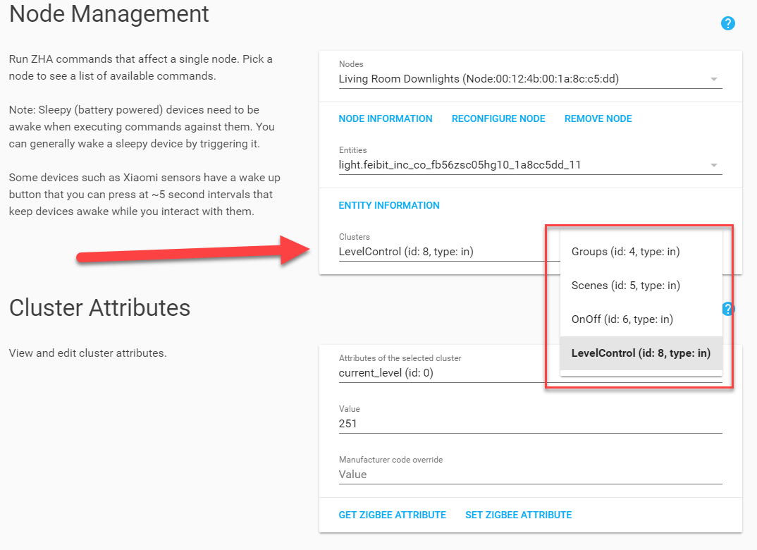

I have little experience with ZHA so far, but I believe that I should somehow be able to use the ZHA Panel to understand how to replicate these functions then build an automation to manage it (in Node Red)?
The trouble is that for all Clusters & Attributes most return null. I tried setting the level to a custom value, then turning the switch on - but writing these attributes to the switch seems to throw it offline then I’m forced to re-pair.
I’m creating THIS GOOGLE SHEET to list all the Clusters and Attributes and their values to try and understand more.
