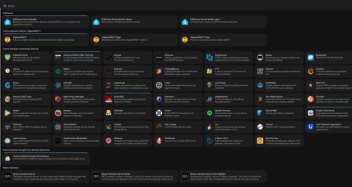

I cant recall since when the complete catalogue of the official Addons is missing, but i discovered it yesterday because the Matter Server isn´t working anymore…
Actually the addon store looks like this:
No official Addons at all.

I tried to restore a backup from last week and also tried the new beta, but this did not change the behavior.
I found a topic, where someone had this issue and solved it with adding DNS Servers to the exisitng ones - tried that, did not solve the problem.

Of course I picked today of all days to update everything from December 2024… Seems like I’m experiencing the same issue. Home Assistant OS running as a VM from Truenas Scale, and I have a lot of core / official addons showing as removed from repository. This includes File editor, Piper, Whisper, openWakeWord, Samba share and Mosquitto broker. Panic!
Tried rebooting the VM from HA System > Reboot, restarting multiple times, but no improvement. Apparently the issue was merged thru Missing addons in the store for the default addons repository. Installed addons report being removed from repository · Issue #5699 · home-assistant/supervisor · GitHub but this is for supervisor, can we expect the same for OS? This is kind of a scary issue for me as I’m still a noob…

Installing the new beta supervisor seems to do the trick so far.
The addons are back since i installed it and everything is working properly.
