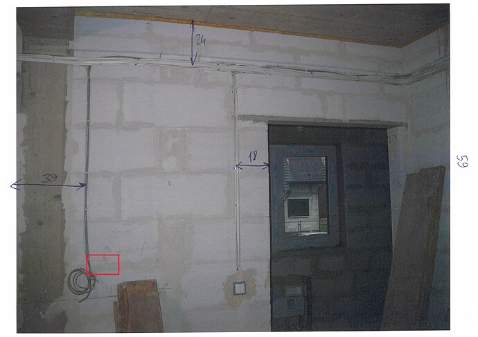

Here is my situation with the target location of the tablet.
What I have available is Ethernet cable and electrical powet 1 meter away.
The picture is from a year ago so now all the walls have been plastered/painted.
