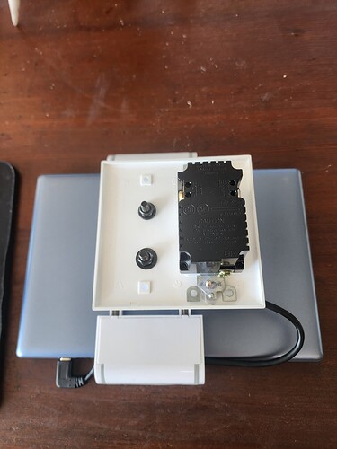

To all those asking, this is the PAD I selected, runs HA perfectly with Android App.
I use this for wall mount:
https://www.amazon.com/dp/B000WVXX2E?psc=1&ref=ppx_yo2ov_dt_b_product_details
Because I have power, I put in a 2-gang box about 10" higher on wall than normal light switches above the light switch so easy to pull power. In that box I have one USB charging outlet and a blank side. I use the blank side of the wall plate for the mount (instead of just going into the drywall).
Here is one ready for installation.
