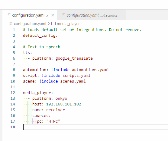

i’ve set up the configuration of media_player in configuration.yaml but I don’t see anything special.
What should I expect from this? I don’t see any Entity or Device popping new.
Restart HA and then check in entities for media player called receiver
Ok, got it
It’s working fine
