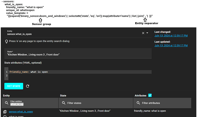

**I went down a rabbit hole on this one. **
Wanted a Message box pop up if AC is on and a door or window was left open for a few minutes.
First I have a group for all my door and window sensors to have a sensor available if one of them are open.
Then I created a sensor to show a list of what is open when on.
- sensors:
    what_is_open:
      friendly_name: "what is open"
      unique_id: whatisopen
      value_template: >
       "{{expand('binary_sensor.doors_and_windows') | selectattr('state', 'eq', 'on')| map(attribute='name') | list | join(' & ')  }}"
But I could not get it to work when referencing the sensor within the payload of the automation. Maybe someone can explain to how if possible?
It works fine after I just added the template code directly into the action payload in the automation like below.
