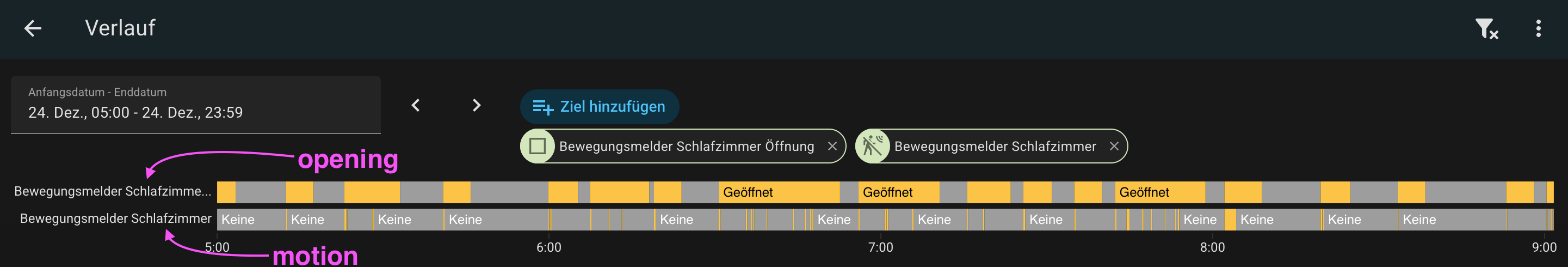

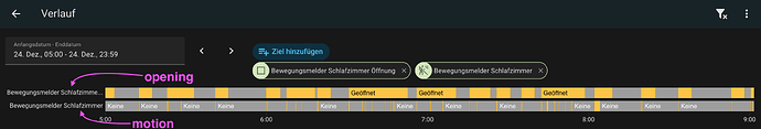

This visual “summary” helped me a lot in understanding the opening sensor of my SML003:
Indeed it stays on for some time, after the motion has been triggered.
