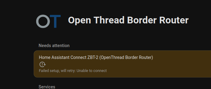

I’m pretty new at integrating Thread with HA and having an issue with a ZBT-2 (firmware 2.4.4.0) and the OTBR integration talking. I’m running on a Home Assistant Green and I had it working and configured with a Eufy door lock, so everything was happy before I had a short power blip today. In my integrations list the ZBT-2 still shows up as happy, however, the border router integration is showing as failed setup.
Here’s the detail info out of the log for OTBR add-on:
Add-on: OpenThread Border Router
OpenThread Border Router add-on
Add-on version: 2.16.0
You are running the latest version of this add-on.
System: Home Assistant OS 17.0 (aarch64 / green)
Home Assistant Core: 2026.1.3
Home Assistant Supervisor: 2026.01.1
I’ve tried actually restarting the HA Green, both with the ZBT-2 plugged in and unplugged, reconnecting it back in after it was fully booted. Tried reloading the add-on, again both with the ZBT-2 plugged in and not.
I’m not really sure where to go next, the logs I’m looking at don’t have something super obvious at least to me. Any ideas would be greatly appreciated.
Any clues in the system log?
Nothing that seems obvious, but it’s possible I’m not looking in the right log, I haven’t had to do all that much troubleshooting to this point.
The OTBR log seems to have stopped hours ago, and hasn’t written anything through multiple reboots which seems odd to me, even with debugging turned on but maybe it only writes when it’s talking to endpoints.
Supervisor doesn’t have any non-info level lines after my modem and router came back
The Host log only makes mention of ZBT-2 when it initializes it, and moves on. No warnings or anything

2026-02-03 11:08:04 homeassistant serialx.descriptor_transport[237] DEBUG Closing file descriptor 7
2026-02-03 11:08:04 homeassistant serialx.descriptor_transport[237] DEBUG Calling protocol `connection_lost` with exc=None
2026-02-03 11:08:04 homeassistant zigpy.serial[237] DEBUG Connection lost: None
  File "/usr/local/lib/python3.13/dist-packages/universal_silabs_flasher/spinel.py", line 260, in send_frame
    return await asyncio.shield(future)
asyncio.exceptions.CancelledError
  File "/usr/local/bin/migrate_otbr_settings.py", line 223, in <module>
    asyncio.run(main())
  File "/usr/lib/python3.13/asyncio/runners.py", line 195, in run
    return runner.run(main)
  File "/usr/lib/python3.13/asyncio/runners.py", line 118, in run
    return self._loop.run_until_complete(task)
  File "/usr/lib/python3.13/asyncio/base_events.py", line 725, in run_until_complete
    return future.result()
  File "/usr/local/bin/migrate_otbr_settings.py", line 154, in main
    hwaddr = await get_adapter_hardware_addr(
    ...<3 lines>...
  File "/usr/local/bin/migrate_otbr_settings.py", line 101, in get_adapter_hardware_addr
    rsp = await protocol.send_command(
    ...<2 lines>...
  File "/usr/local/lib/python3.13/dist-packages/universal_silabs_flasher/spinel.py", line 292, in send_command
    return await self.send_frame(frame, **kwargs)
  File "/usr/local/lib/python3.13/dist-packages/universal_silabs_flasher/spinel.py", line 259, in send_frame
    async with asyncio_timeout(timeout):
  File "/usr/lib/python3.13/asyncio/timeouts.py", line 116, in __aexit__
    raise TimeoutError from exc_val
TimeoutError
[11:08:04] WARNING: otbr-agent exited with code 1 (by signal 0).
Chain OTBR_FORWARD_INGRESS (0 references)
target     prot opt source               destination
DROP       all  --  anywhere             anywhere             PKTTYPE = unicast
DROP       all  --  anywhere             anywhere             match-set otbr-ingress-deny-src src
ACCEPT     all  --  anywhere             anywhere             match-set otbr-ingress-allow-dst dst
otbr-ingress-deny-src-swap
otbr-ingress-allow-dst-swap
Chain OTBR_FORWARD_EGRESS (0 references)
[11:08:04] INFO: OTBR firewall teardown completed.
s6-svlisten1: fatal: /run/s6-rc/servicedirs/otbr-agent failed permanently or its supervisor died
s6-rc: warning: unable to start service otbr-agent: command exited 1
s6-rc: info: service legacy-cont-init: stopping
s6-rc: info: service banner: stopping
s6-rc: info: service mdns: stopping
/run/s6/basedir/scripts/rc.init: warning: s6-rc failed to properly bring all the services up! Check your logs (in /run/uncaught-logs/current if you have in-container logging) for more information.
/run/s6/basedir/scripts/rc.init: fatal: stopping the container.
s6-rc: info: service banner successfully stopped
Default: mDNSResponder (Engineering Build) (Jan 28 2026 17:15:03) stopping
s6-rc: info: service legacy-cont-init successfully stopped
s6-rc: info: service fix-attrs: stopping
s6-rc: info: service fix-attrs successfully stopped
s6-rc: info: service s6rc-oneshot-runner: stopping
s6-rc: info: service s6rc-oneshot-runner successfully stopped
[11:08:04] INFO: mDNS ended with exit code 4 (signal 0)...
s6-rc: info: service mdns successfully stopped
I’ve reverted versions and unknowingly, it’s now working.
[12:12:52] INFO: Starting socat TCP client for OTBR daemon...
Add-on version: 2.15.3
There is an update available for this add-on!
s6-rc: info: service socat-otbr-tcp successfully started
Latest add-on version: 2.16.0
Please consider upgrading as soon as possible.
System: Home Assistant OS 17.0 (amd64 / qemux86-64)
Home Assistant Core: 2026.1.1
Just to confirm, did it start working for you after you rolled back OTBR or after you updated it to latest?
Not entirely sure why, but I have this functioning now. I restored from a backup taken the morning before the power outage, and had no success. I then deleted the OTBR add-on, restored it again, and everything is happy. Chalk one up for “ghost in the machine” I guess.
I am running into the same issue. I had the ZBT-2 plugged in, then I upgraded HA and it told me to restart so I unplugged and re-plugged, and then OTBR was showing a similar error.
I tried to look for OTBR logs from the HA webapp, and I don’t see anything. Where are you getting these logs from? I can ssh in, but I am not sure where to find the logs on the filesystem
s6-rc: info: service mdns: starting
s6-rc: info: service s6rc-oneshot-runner: starting
I am still not sure where these logs are, but reporting how I fixed this in case it helps somebody else.
I went into the ZBT-2 device and re-selected the thread integration, then deleted the OTBR app and reinstalled it. I had to pick a serial port for the app, but fortunately, one of the serial ports was ..../Nabu_Casa_ZBT-2_.... so that wasn’t too hard.
The app was installed, and it installed the driver (aka OTBR integration) and configured it properly. The integration does not show any errors now.
