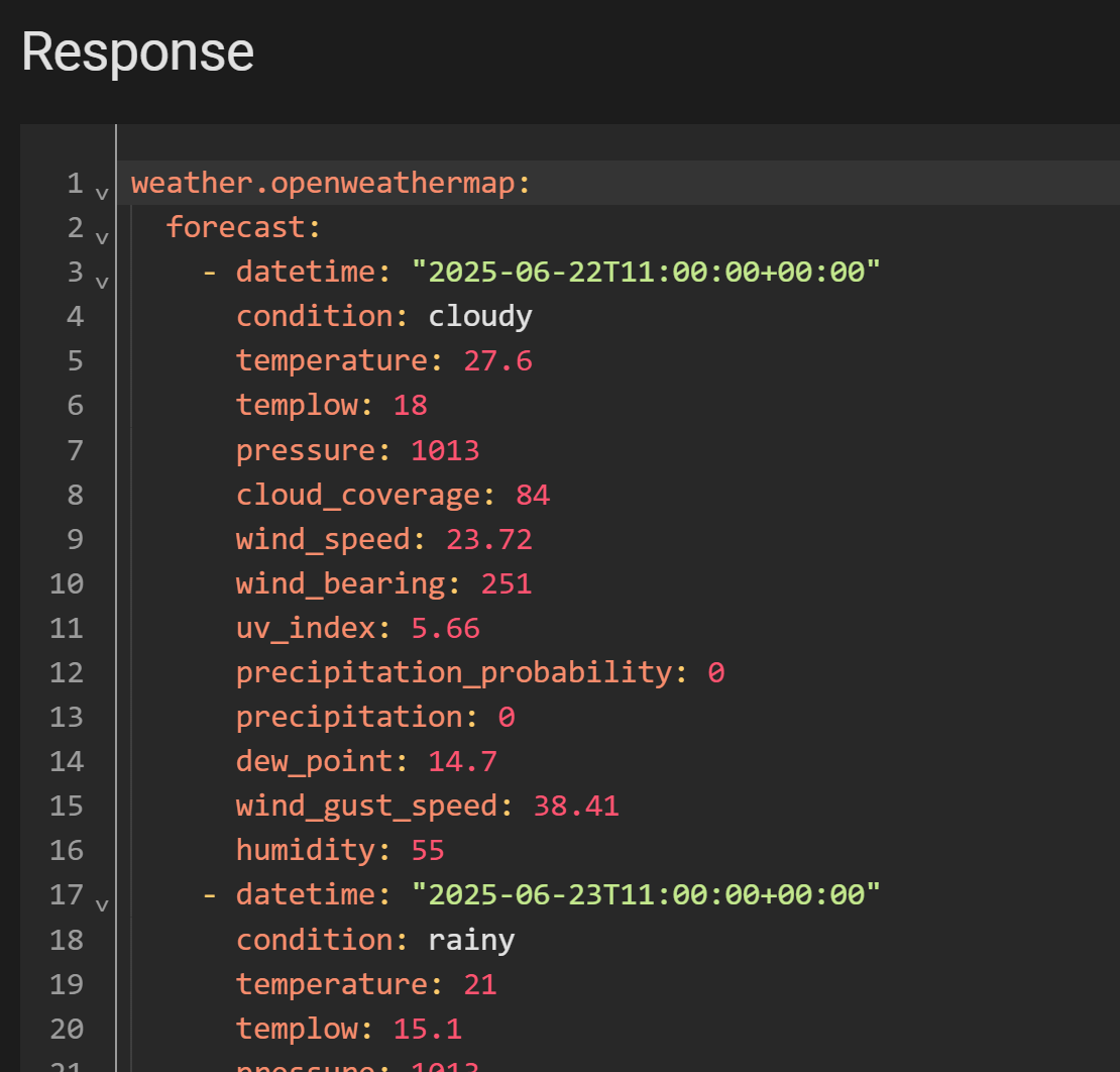

If I go to the developers tools, I can run
action: weather.get_forecasts
  entity_id: weather.openweathermap
  type: daily
to load all the attribute information from OWM entity. There I can see the needed information is available from OWM weather provider.
However, I cannot calculate with this information in an automation.

Please next time post formatted text (also for output) instead of screenshots, because we cannot copy from them. You can for instance create a template sensor like this to put the data in attributes (untested, may have small bugs). You can put this in templates.yaml:
 - trigger:
      - platform: time_pattern
        minutes: /1
    action:
      - service: weather.get_forecasts
          type: daily
        response_variable: daily
    sensor:
      - name: Weather Forecast values
        unique_id: weather_forecast_values
        state: "{{ now().isoformat() }}"
        attributes:
          precipitation_0: "{{ daily['weather.openweathermap'].forecast[0].precipitation }}"
          precipitation_1: "{{ daily['weather.openweathermap'].forecast[1].precipitation }}"
from it you can guess the other attributes. I set it to get the info every minute because you have to wayt that long to get the first results. When it works, increase the time because the numbers won’t change this fast.
