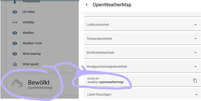

Can you elaborate on what you mean by “my OWM weather entity” - not sure where that name is specified (outside this template)
It’s the entity_id of the open weather map entity that is created by the open weather map integration. Left is the weather entity in the dashboard, right is the config view of that entity where you get the entity id.
