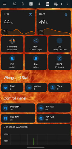

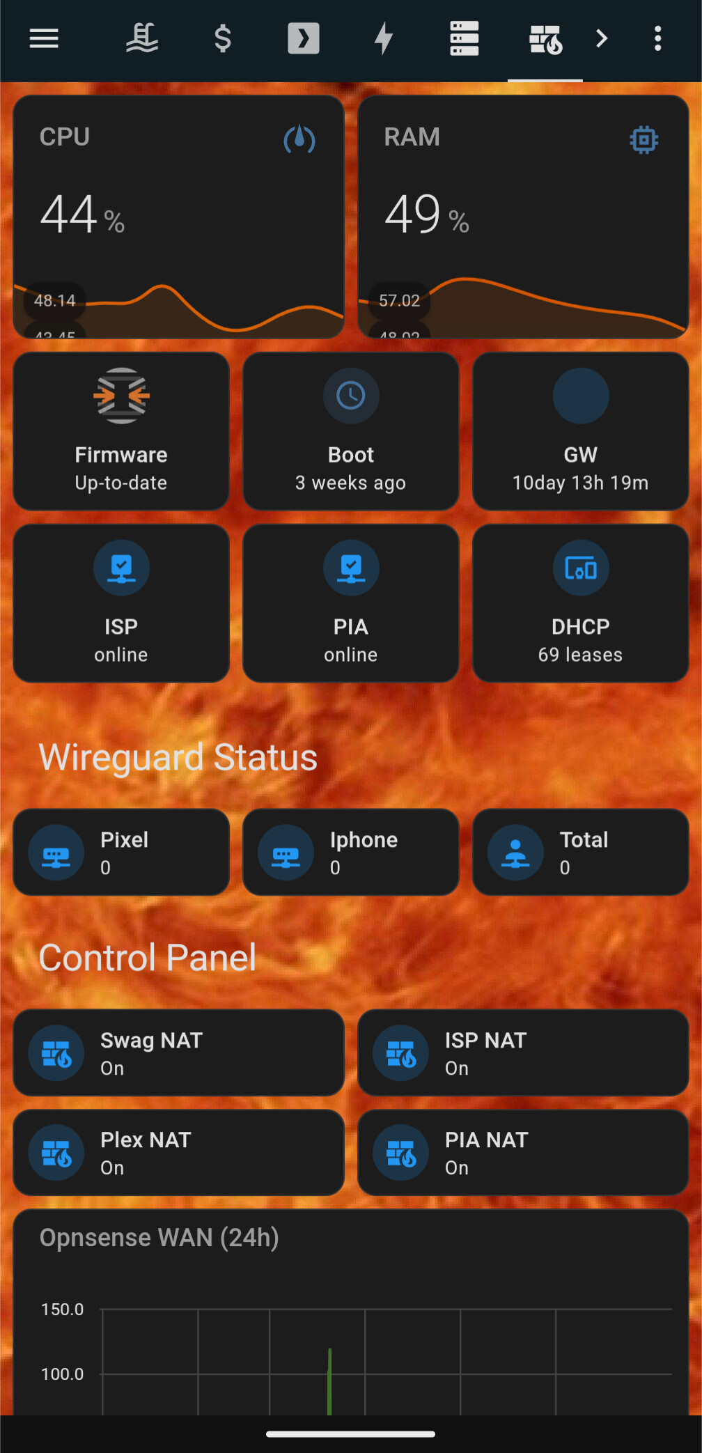

I set this up and got this working fairly quickly this morning. I am loving it so far and it’s like an early Christmas with the 303 available Opnsense entities!
Here’s my dashboard design so far:
I also set up an automation rule to notify when wireguard clients are connected:

My latest dashboard version:

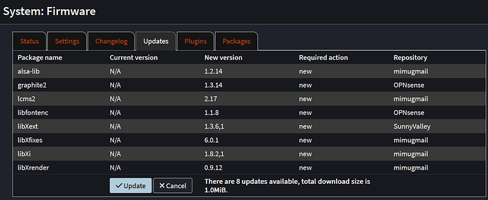

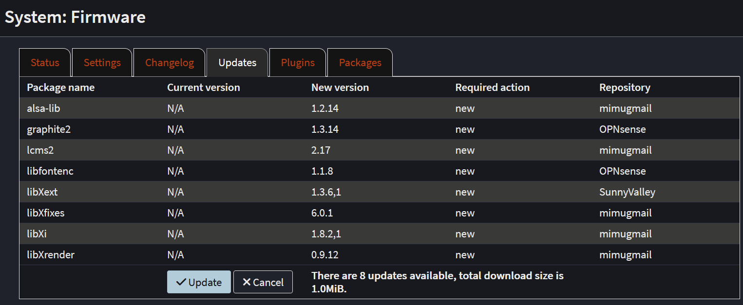

I use the Zenarmor plugin which conflicts with this repo. As a result, every time I check for updates it returns ~8 packages with a current version of ā€œN/Aā€ that OPNsense thinks need to be updated (screenshot below), but they are already at the current version. If I update them and check again for updates, it says they need to be updated again. I’ve found that removing the os-homeassistant-maxit plugin resolves the issue, but that’s not an ideal solution.
I’m curious if anyone else has found a better workaround for using these two plugins together.
