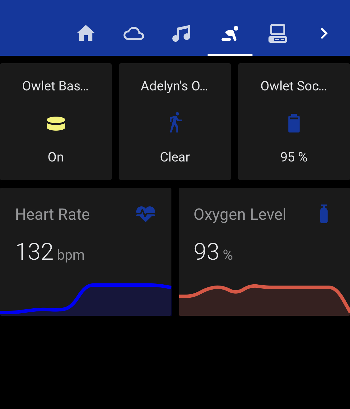

I am not sure what is up, but I thought that the values for O2 and Heart would be able to be shown in history-graph… anyone got this working?
Otherwise, was pleasantly surprised to see this creep into the latest release… Thanks for all your efforts
I am using a Lovelace custom mini graph and has been working fine
