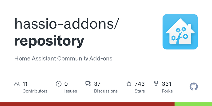

AdGuard Home ( i see there should be an arm package available Packages · Home Assistant Community Add-ons · GitHub)
Unifi Network Application (should be too an arm package for available Packages · Home Assistant Community Add-ons · GitHub)
Studio Code Server ( don’t see an arm package soo it could be that this one is not available any more Packages · Home Assistant Community Add-ons · GitHub)

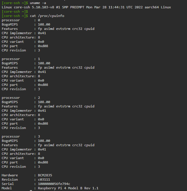

What model CPU does your board have?

and the info from ssh, looks good too me.

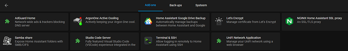

The packages that are not available any more have another icon too:
and changelog is also not available:
No changelog found for add-on a0d7b954_adguard!

found the solution, this repository was not available any more:
don’t know why, but after adding i can now update the add-ons.
