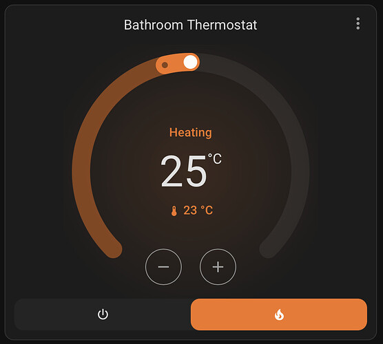

Here’s how my thermostat card looks in Home Assistant:
Hope this helps! Let me know if you have any other questions.
