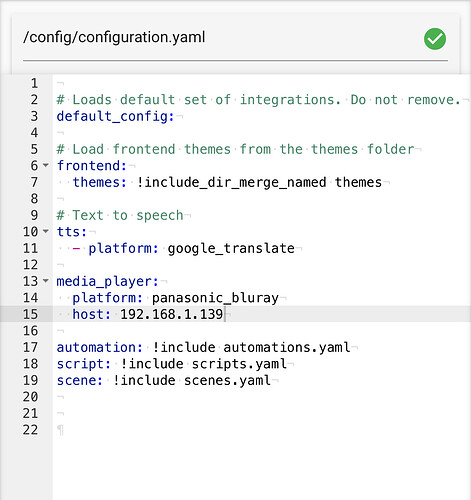

I’m trying to get my UB420 working with HA and added it to the configuration.yaml. HA sees the player but I have no controls and it always shows as Idle. Did I add it properly?
