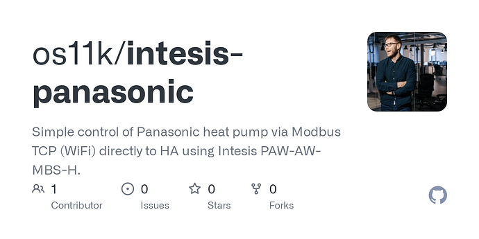

Hi!
I don’t want to steal any spotlight from Carlos and his fantastic work, but if someone needs I wrote config for integration panasonic heat pump using modbus:
To make it work you will need to buy modbus adapter:
