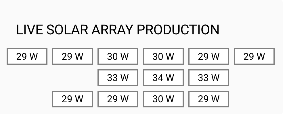

I took the lazy man’s route and just used custom button cards with borders to represent my solar array. Admittedly it doesn’t look as fancy as those with graphical backgrounds, but it gets the job done and is all I really need.
type: custom:mod-card
style: |
  ha-card {
    font-family: "roboto";
    --primary-text-color: black;
    --secondary-text-color: black;
    font-weight: bold;
    font-size: 16px !important;
card:
  type: conditional
  conditions:
    - condition: state
      entity: sensor.ecu_inverter_status
      state_not: unavailable
  card:
    type: vertical-stack
    title: LIVE SOLAR ARRAY PRODUCTION
    cards:
      - type: horizontal-stack
        cards:
          - type: custom:button-card
            entity: sensor.inverter_702000836649_power_ch_2
            show_name: false
            show_icon: false
            show_state: true
            styles:
              card:
                - border-radius: 0px
                - border: 2px solid grey
            entity: sensor.inverter_702000836649_power_ch_1
            show_name: false
            show_icon: false
            show_state: true
            styles:
              card:
            entity: sensor.inverter_702000833555_power_ch_2
            show_name: false
            show_icon: false
            show_state: true
            styles:
              card:
            entity: sensor.inverter_702000833555_power_ch_1
            show_name: false
            show_icon: false
            show_state: true
            styles:
              card:
            entity: sensor.inverter_702000836648_power_ch_2
            show_name: false
            show_icon: false
            show_state: true
            styles:
              card:
            entity: sensor.inverter_702000836648_power_ch_1
            show_name: false
            show_icon: false
            show_state: true
            styles:
              card:
        cards:
            entity: input_text.text0
            show_name: false
            show_icon: false
            show_state: true
            styles:
              card:
                - background-color: rgba(0, 0, 0, 0)
                - box-shadow: none
                - border: none
            show_name: false
            show_icon: false
            show_state: true
            styles:
              card:
                - box-shadow: none
                - border: none
            entity: sensor.inverter_702000836651_power_ch_2
            show_name: false
            show_icon: false
            show_state: true
            styles:
              card:
            entity: sensor.inverter_702000836650_power_ch_1
            show_name: false
            show_icon: false
            show_state: true
            styles:
              card:
            entity: sensor.inverter_702000836650_power_ch_2
            show_name: false
            show_icon: false
            show_state: true
            styles:
              card:
            show_name: false
            show_icon: false
            show_state: true
            styles:
              card:
                - box-shadow: none
                - border: none
        cards:
            show_name: false
            show_icon: false
            show_state: true
            styles:
              card:
                - box-shadow: none
                - border: none
            entity: sensor.inverter_702000836655_power_ch_2
            show_name: false
            show_icon: false
            show_state: true
            styles:
              card:
            entity: sensor.inverter_702000836655_power_ch_1
            show_name: false
            show_icon: false
            show_state: true
            styles:
              card:
            entity: sensor.inverter_702000833551_power_ch_1
            show_name: false
            show_icon: false
            show_state: true
            styles:
              card:
            entity: sensor.inverter_702000833551_power_ch_2
            show_name: false
            show_icon: false
            show_state: true
            styles:
              card:
            show_name: false
            show_icon: false
            show_state: true
            styles:
              card:
                - box-shadow: none
                - border: none
