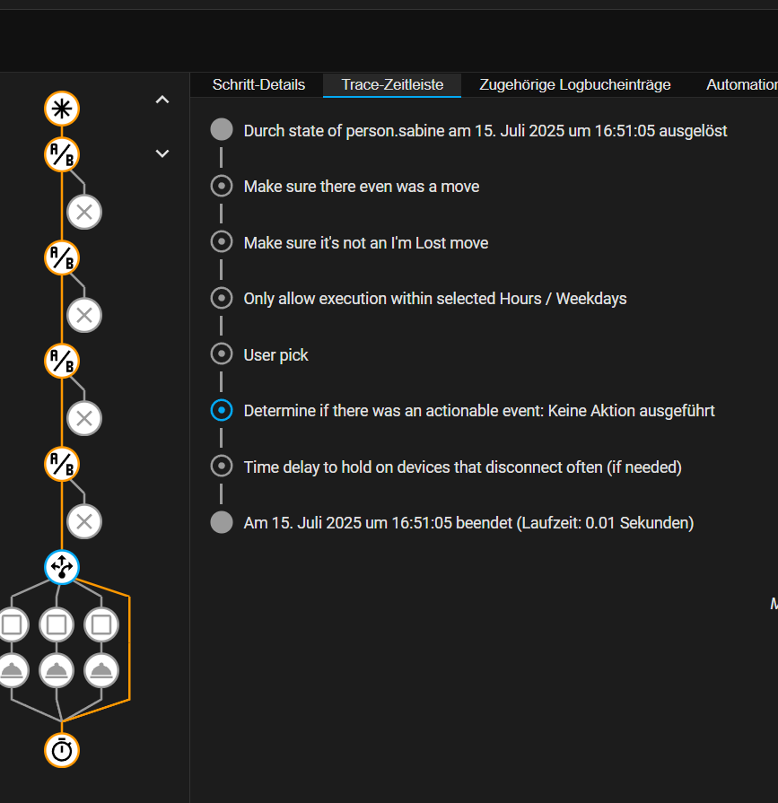

So here is the corresponding trace:
It should go to the step under the arrow (i presume) .

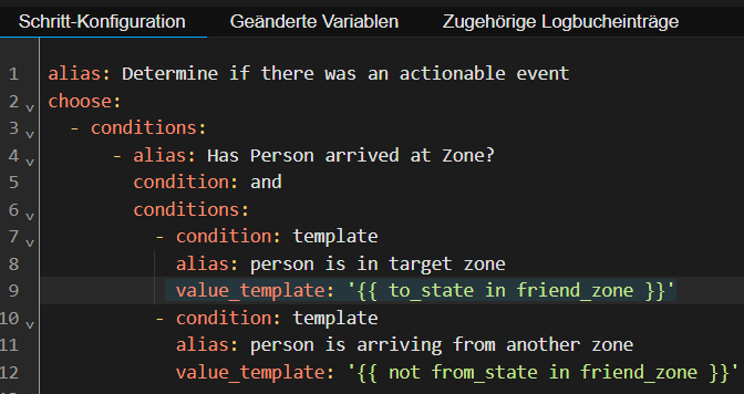

Here is the step config which I struggle to find the problem:
My guess is there is something wrong in the conditions of ā€œHas Person arrived at Zone?ā€.
alias: Determine if there was an actionable event
choose:
  - conditions:
      - alias: Has Person arrived at Zone?
        condition: and
        conditions:
          - condition: template
            alias: person is in target zone
            value_template: '{{ to_state in friend_zone }}'
            alias: person is arriving from another zone
            value_template: '{{ not from_state in friend_zone }}'

The trace is saying that trigger is probably to and from the same zone. Hard to say without the words but that is the most likely.
You don;'t need to post it here, just look at it yourself, but in the trace click the top asterix and then changed variables on the right. there it will tell you the from_state for person and zone, and the to_state person and zone. If they match then there was no zone change so it won’t pick ā€˜left a zone’, ā€˜entered a zone’, or ā€˜left and entered a zone’ in the decision tree at the bottom, which looks like the case.
There will be a trigger every few minutes where the GPS changes a few digits and the person doesn’t move far enough to change a zone. Those have to be screened out. Try to manually change te device location out of the zone and let it come back while testing.

So this looks like its fulfilled but does not start the ā€œHas Person arrived at Zone?ā€ step.
        condition: and
        conditions:
Any other ideas to investigate?

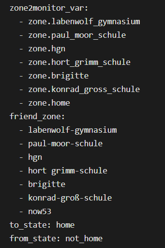

Is it possible that this blueprint does not work if the name of your home is not ā€œHomeā€? In my case, my home is named ā€œNoW53ā€. If I look at the traces and the zone2monitor_var, the home zone appears as ā€œzone.homeā€ whereas in the friend_zones it appears as ā€œnow53ā€.
zone2monitor_var:
  - zone.zone1
  - zone.zone2
  - zone.zone3
  - zone.home
  - zone.zone4
  - zone.zone5
friend_zone:
  - zone1
  - zone2
  - zone3
  - now53
  - zone4
  - zone5
Now if someone arrives at home, the automation triggers but does not send a notification because the condition ā€œto_state in friend_zoneā€ in ā€œHas Person arrived at Zoneā€ is not met, since in the state, the zone is named ā€œhomeā€, but the friend_zone is named ā€œnow53ā€.
Could this happen because zone2monitor_var is using states.zone whereas friend_zone is populated using the friendly_name or am I reading this completely wrong?

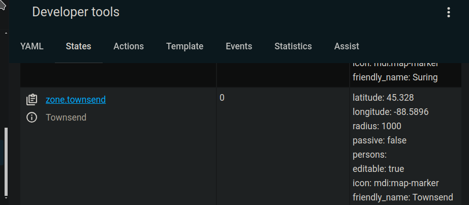

Well, it’s possible. However it does grab the friendly name of the zone, so look in the developer console Open your Home Assistant instance and show your state developer tools.
at the zone in question.
In that case Townsend for instance so make sure you know what you are searching against.

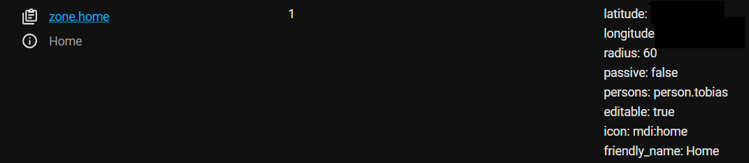

Thanks for the reply - I made a little experiment regarding the info for zone.home in the developer console. If I name the (default) zone.home ā€œHomeā€ via Settings - System - General, the automation triggers on enter/leave and a notification gets send:
If I change the friendly name back to its original ā€œNoW53ā€ in the system settings:
the condition check ā€œDetermine if there was an actionable eventā€ fails.
I assume this is due to the fact that the to_state is ā€œhomeā€ like in the zone2monitor_var list but in the friend_zone list the friendly name ā€œnow53ā€ is used.
And I guess that therefore value_template: '{{ to_state in friend_zone }}' does not evaluate to true:
Well as you can see my current zone.home is called somerhome, and 3 4 of the friendly names are not exactly what the zone.x names are…
people2monitor_var:
  - person.julie
zone2monitor_var:
  - zone.home
  - zone.belva
  - zone.lakewood
  - zone.mountain
  - zone.shawano
  - zone.suring
  - zone.townsend
  - zone.chaloupka_abode
  - zone.two_rivers
friend_zone:
  - somerhome
  - belva
  - lakewood
  - mountain
  - shawno
  - suring
  - townsend
  - chaloupka abode
  - two rivers
to_state: home
This is working.
Perhaps an HA restart is needed for the zone.home to update? It is a bit more special than the others.
