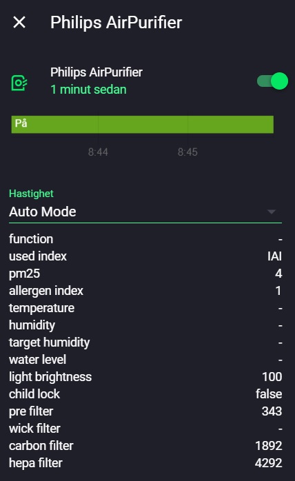

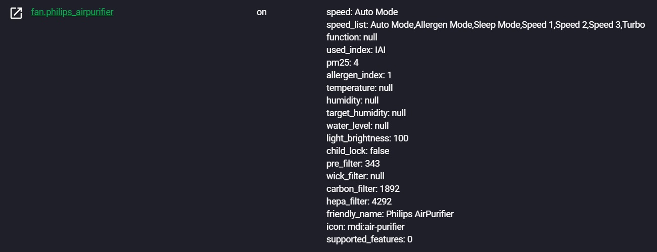

My Philips 3259 dont have temperature, humidity, water or wick-filter and I also see “function: null” that I apparently dont have.
Another problem: I set the light to OFF/Zero in the mobileapp, Hassio dont register the change until the “30-seconds sound” and Im getting Zero in state light_brightness but Hassio turns the light back on and after another “30-seconds sound” it changes the state back to 100.
I think something is not working with Philips 3259. What to do?
If I remove the code for the fan, Philips 3259 stop acting strange.

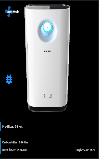

I can see the picture-element for a second then it dissapears!??? Never encountered this before.
The picture that flashes by is this:
After 1 second I dont see it anymore. Why?
Whats wrong with my code?
