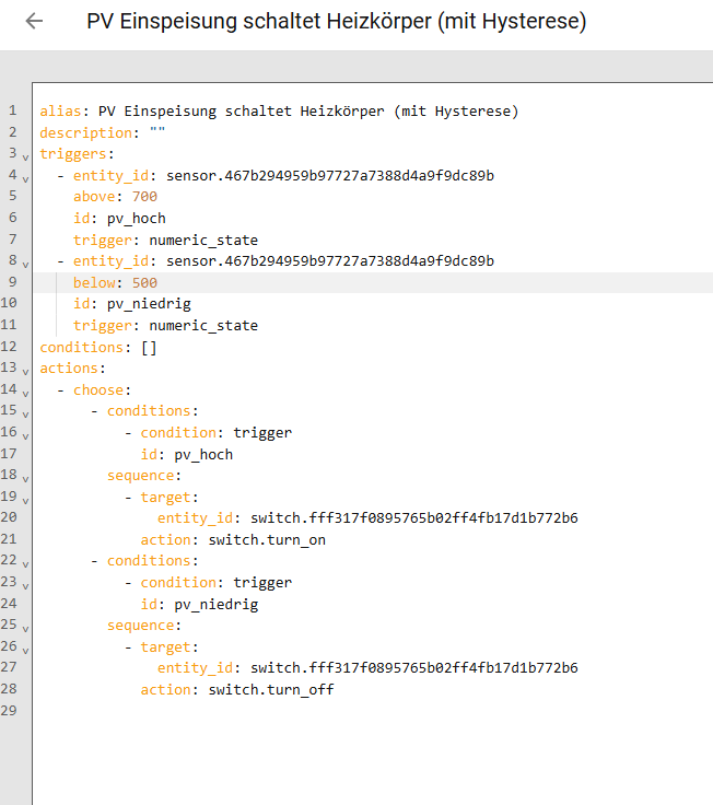

Could someone please check this script for errors? I want to control a bathroom radiator when my photovoltaic system feeds power into the public grid. I’d like to do it like this:
Switch on at high power, e.g., > 700 W
Switch off only at significantly lower power, e.g., < 500 W
Thanks
alias: PV Einspeisung schaltet Heizkörper (mit Hysterese)
description: “”
triggers:
  • entity_id: sensor.467b294959b97727a7388d4a9f9dc89b
    above: 700
    trigger: numeric_state
    below: 500
    conditions:
    actions:
  • choose:
    • conditions:
      • condition: trigger
        sequence:
      • target:
        entity_id: switch.fff317f0895765b02ff4fb17d1b772b6
        action: switch.turn_on
    • conditions:
        sequence:
      • target:
        action: switch.turn_off

Hello
Here is the original text cut out
Thanks and i wishing you a fantastic New Year
Do not post pictures of code. Please paste in the actual code as formatted text like @Sir_Goodenough showed you in his earlier post.
If you’re having an issue with your automation, it’s probably because the entity_id is messed up.
It should either be all human readable, like switch.your_sensor, or else it’ll be an alphanumeric value.
You seem to have both in the same line. Read this to learn more about it Why and how to avoid device_ids in automations and scripts
