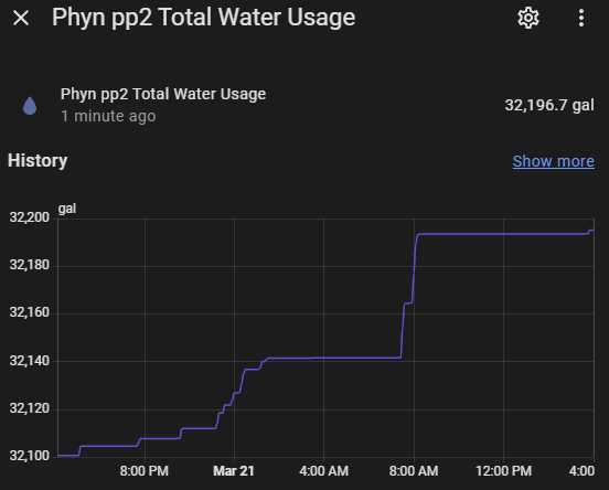

I do get realtime flow data with this integration that matches what the Phyn app shows.

I’m not sure which device you have, but generally there is a total water count that you can see the total water usage for each day and take the delta. It also integrates with the energy dashboard.

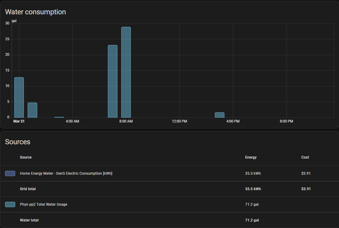

Is the time increment here per hour? Has anyone tried to increase the polling rate?
The Flume API allows for 120 requests an hour, effectively every 30 seconds.
It depends. The integration tries to establish a MQTT connection which gets updated every 5 seconds. Manual polling is every 60 seconds if MQTT is not working. The stats in the picture above are just aggregated stats from the energy dashboard.
