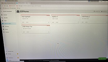

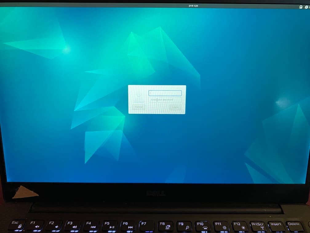

I have a similar setup on a laptop: Proxmox + Home Assistant VM. You don’t need a 2nd VM for desktop access; I just installed xFCE directly into Proxmox, and I got an GUI welcome screen. You can simply turn that off when not needed.
