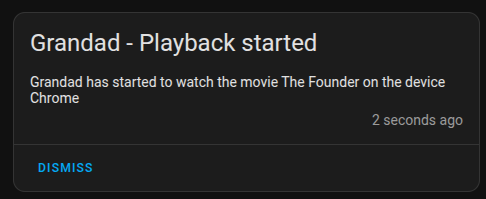

Can you add an option to not specify client(s) ?
I have an automation where I would like to show who plays what no matter what user and/or player they are coming from.
hey @riro,
Try using the Generic Playback actions, and under that the playback started option. This is triggered before the player specific actions.
I copied this code, from the Admin Playback Started example in the blueprint to the Generic section (
The Admin Playback Started shows all users minus the main Plex account). I can see notifications appearing :
metadata: {}
  title: "{{ payload.Account.title }} -  Playback started"
  notification_id: plex_user_playback_{{ payload.Account.title }}
  message: >-
    {{ payload.Account.title }} has started {% if payload.Metadata.type ==
    'track' %}listening to {{ payload.Metadata.title}} by {% if
    payload.Metadata.originalTitle is defined and
    payload.Metadata.originalTitle|length > 0 %} {{
    payload.Metadata.originalTitle }} {% else %} {{
    payload.Metadata.grandparentTitle }} {% endif %} from the album {{
    payload.Metadata.parentTitle }}{% elif payload.Metadata.type == 'movie' %}to
    watch the movie {{ payload.Metadata.title }} ({{ payload.Metadata.year }})
    directed by {{ payload.Metadata.Director[0].tag }}{% elif
    payload.Metadata.type == 'episode' %}to watch the TV show {{
    payload.Metadata.grandparentTitle }} Season {{ payload.Metadata.parentIndex
    }} Episode {{ payload.Metadata.index }} ({{ payload.Metadata.title }}){%
    elif payload.Metadata.type == 'album' %}listening to the album {{
    payload.Metadata.title }} by {{ payload.Metadata.parentTitle }}{% else %}
    interacting with Plex Media Server {{ payload.Server.title }}{% endif %}{%
    if payload.Player.title|length > 0 %} on the device {{ payload.Player.title
    }}{% endif %}
action: persistent_notification.create
Ah, that easy :slight_smile:
(btw, really annoying with the formatting of the Jinja when switching between UI and yaml editor)
