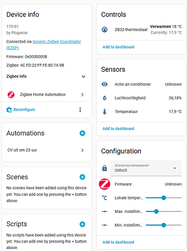

In my setup the Emma Wired Pro is direct connected via ZigBee without Adam.
This is what is showed in HA:
I can set the temperature via a automation.
@pino I see you are using ZHA. Good to see that this kind-of works too.
