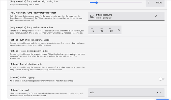

Hello, the optional fields (turn on block, heater block and turn off block) is empty, there is no where I can select my entities.
Am I doing something wrong or is it A bug?

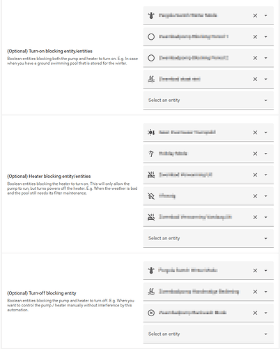

That is strange, that should work. Can you post a screenshot how it looks for you? This is how it looks in my environment:
