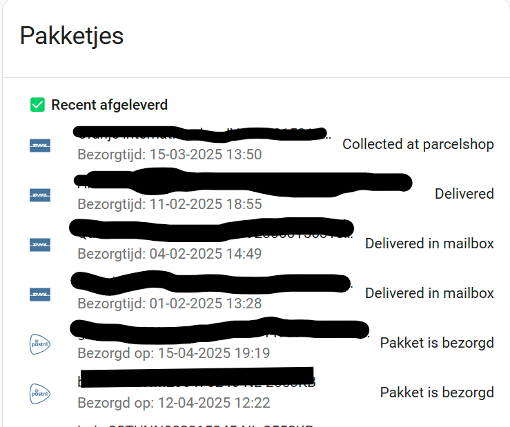

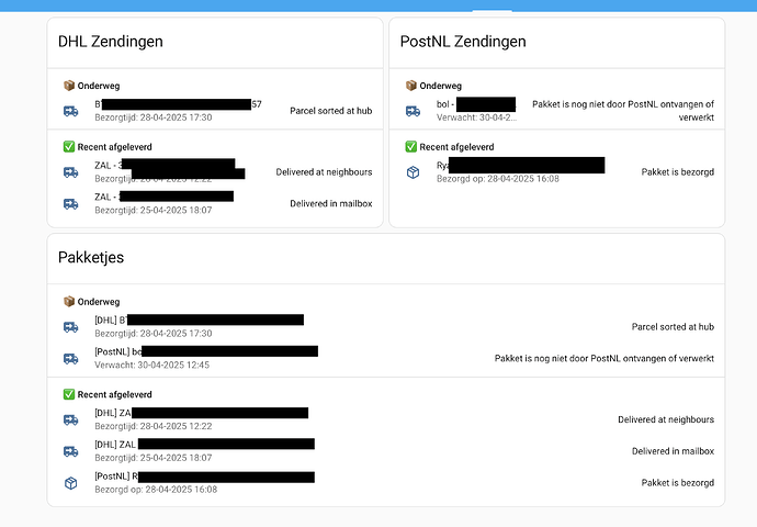

After a few hours of crafting I made the following cards based on car entities.
You can choose between separate cards for PostNL and DHL. Let packages be those that are on their way and packages up to and including 3 days that have already been delivered. You can easily change this yourself in the auto-entities config.
And then a combined card of both. That then also puts in brackets who the deliverer is.

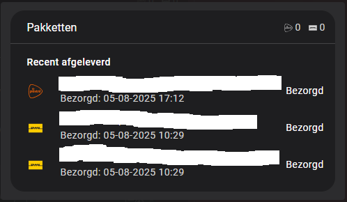

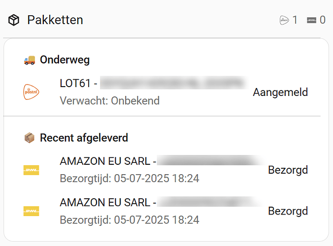

@rdekruyf Very nice, thanks for sharing the code.
I changed the text DHL / PostNL with icons phu:dhl and phu:postnl.
Do you know how to color the icons and how to sort data by date ?

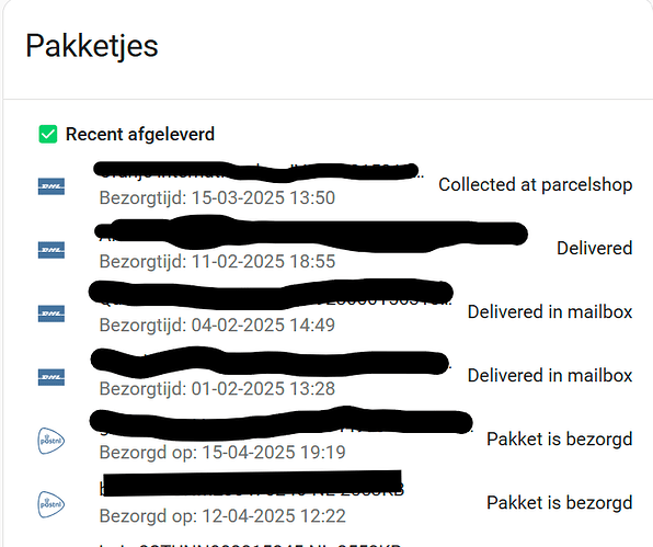

I’ve adjusted it a little since it was giving me errors on the postnl sensor and the collected at parcelshop werent tagged as deliverd:

Made some further changes to implement it in my Sections dashboard:
Translated the DHL statusses to Dutch and fixed some of the really long statusses of PostNL.
Also made the packages clickable which redirects to the track&trace website of PostNL and DHL respectively.
The heading shows 2 entities: one counter for PostNL and one for DHL.
type: heading
heading: Pakketten
heading_style: title
icon: mdi:package-variant-closed
badges:
  - type: entity
    show_state: true
    show_icon: true
    entity: sensor.postnl_delivery
    icon: phu:postnl
  - type: entity
    show_state: true
    show_icon: true
    entity: sensor.aantal_aankomende_dhl_pakketjes
    icon: phu:dhl
For the DHL counter, I had to make a helper sensor template that only counts the incoming packages:

          {# PostNL recent afgeleverd pakketten (max 3 dagen) #} {% for pakket
          in postnl_delivered %}
            {% set tijd_raw = pakket.delivery_date %}
            {% set tijd = 'Onbekend' %}
            {% set tijd_ts = 0 %}
            {% set dagen_verschil = 999 %}
            {% if tijd_raw %}
              {% set tijd_ts = as_timestamp(tijd_raw) %}
              {% set dagen_verschil = (now().timestamp() - tijd_ts) / 86400 %}
              {% set tijd_datetime = tijd_raw|as_datetime %}
              {% set dag = ['Maandag','Dinsdag','Woensdag','Donderdag','Vrijdag','Zaterdag','Zondag'] %}
              {% set dag = dag[tijd_datetime.weekday()] %}
              {% set tijd = dag + ' ' + as_timestamp(tijd_datetime)|timestamp_custom('%H:%M') %}
            {% endif %}
            {% if dagen_verschil <= 3 %}
              {% set naam = pakket.name if pakket.name else 'Onbekende afzender' %}
              {% set barcode = pakket.key %}
              {% set nette_status = pakket.status_message | default('Status onbekend') %}
              {% if 'Pakket is bezorgd' in nette_status %}
                {% set nette_status = 'Bezorgd' %}
              {% endif %}
              {% set postnl_track_url = pakket.url if pakket.url is defined else 'https://www.postnl.nl/tracktrace' %}
              {% set row = {
                'type': 'custom:template-entity-row',
                'entity': 'sensor.postnl_delivery',
                'name': '' ~ naam ~ ' - ' ~ barcode,
                'state': nette_status,
                'secondary': tijd,
                'icon': 'phu:postnl',
                'color': '#FB6200',
                'tap_action': {
                  'action': 'url',
                  'url_path': postnl_track_url
                'sort_tijd': tijd_ts
              {% set postnl_recent_afgeleverd.list = postnl_recent_afgeleverd.list + [row] %}
            {% endif %}
          {% endfor %}
          {# Eindlijst bouwen #} {% set all_onderweg_items = [] %} {% if
          dhl_onderweg.list %}
            {% set all_onderweg_items = all_onderweg_items + dhl_onderweg.list %}
          {% endif %} {% if postnl_onderweg.list %}
            {% set all_onderweg_items = all_onderweg_items + postnl_onderweg.list %}
          {% endif %} {% set all_onderweg_items_sorted = all_onderweg_items |
          sort(attribute='sort_tijd') %}
          {% set all_recent_afgeleverd_items = [] %} {% if
          dhl_recent_afgeleverd.list %}
            {% set all_recent_afgeleverd_items = all_recent_afgeleverd_items + dhl_recent_afgeleverd.list %}
          {% endif %} {% if postnl_recent_afgeleverd.list %}
            {% set all_recent_afgeleverd_items = all_recent_afgeleverd_items + postnl_recent_afgeleverd.list %}
          {% endif %} {% set all_recent_afgeleverd_items_sorted =
          all_recent_afgeleverd_items | sort(attribute='sort_tijd',
          reverse=true) %}
            {% if all_onderweg_items_sorted | count > 0 %}
                "type": "section",
                "label": "Onderweg"
              {% if all_onderweg_items_sorted | count > 0 %}, {{ all_onderweg_items_sorted | join(',') }}{% endif %}
            {% endif %}
            {# Add a comma between sections ONLY if both exist #}
            {% if (all_onderweg_items_sorted | count > 0) and (all_recent_afgeleverd_items_sorted | count > 0) %},{% endif %}
            {% if all_recent_afgeleverd_items_sorted | count > 0 %}
                "type": "section",
                "label": "Recent afgeleverd"
              {% if all_recent_afgeleverd_items_sorted | count > 0 %}, {{ all_recent_afgeleverd_items_sorted | join(',') }}{% endif %}
            {% endif %}
      show_empty: true

type: custom:auto-entities
card:
  type: entities
  title: Pakketjes
filter:
  template: >
    {# DHL ophalen #}
 {% set dhl_pakketjes = state_attr('sensor.dhl_packages',
    'parcels') or [] %}
{% set dhl_onderweg = namespace(list=[]) %} {% set
    dhl_recent_afgeleverd = namespace(list=[]) %}
    {% for pakket in dhl_pakketjes %}
      {% set status = pakket.status | lower %}
      {% set tijd_raw = pakket.receivingTimeIndication.start if pakket.receivingTimeIndication.start is defined else pakket.receivingTimeIndication.moment %}
      {% if tijd_raw %}
        {% set tijd = as_timestamp(tijd_raw) | timestamp_custom('%d-%m-%Y %H:%M') %}
      {% else %}
      {% endif %}
      {% set naam = pakket.sender.name if pakket.sender.name else 'Onbekende afzender' %}
      {% set barcode = pakket.barcode %}
      {% set nette_status = pakket.status | replace('_', ' ') | lower() | capitalize() %}
      {% set row = {
        'entity': 'sensor.dhl_packages',
        'secondary': 'Bezorgtijd: ' ~ tijd,
        'icon': 'phu:dhl',
        'color': '#ffcc00'
      {% if 'delivered' not in status or 'collected' not in status %}
        {% set dhl_onderweg.list = dhl_onderweg.list + [row] %}
      {% else %}
        {% if pakket.receivedDaysAgo is not none and pakket.receivedDaysAgo <= 40 %}
          {% set dhl_recent_afgeleverd.list = dhl_recent_afgeleverd.list + [row] %}
        {% endif %}
      {% endif %}
    {% endfor %}

    {# Eindlijst bouwen #} [
      {% if (dhl_onderweg.list | count > 0) or (postnl_onderweg.list | count > 0) %}
          "type": "section",
          "label": "🚚 Onderweg"
        {{ dhl_onderweg.list | join(',') }},
        {{ postnl_onderweg.list | join(',') }},
      {% endif %}
      {% if (dhl_recent_afgeleverd.list | count > 0) or (postnl_recent_afgeleverd.list | count > 0) %}
          "type": "section",
          "label": "āœ… Recent afgeleverd"
        {{ dhl_recent_afgeleverd.list | join(',') }},
        {{ postnl_recent_afgeleverd.list | join(',') }}
      {% endif %}
show_empty: true
grid_options:
  columns: full
i managed to have it fixed , but i ntoiced something , for me if any of the lists for (dhl/postnl_onderweg/afgelvered ) is emtpy , then the whole card doesn’t show
so i made a nested if to control the join JSON function to avoid adding an empty list to the section
      "type": "section",
    {% if dhl_onderweg.list | count > 0 %},
    {% endif %}
    {% if postnl_onderweg.list | count > 0 %},
    {% endif %}
{% endif %}
      "type": "section",
    {% if dhl_recent_afgeleverd.list | count > 0 %},
    {% endif %}
    {% if postnl_recent_afgeleverd.list | count > 0 %},
    {% endif %}
{% endif %}
