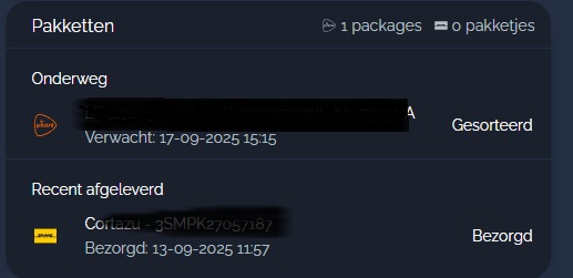

i got it i think the only thing is how do i remove packages and pakketjes.
Schermafbeelding 2025-09-16 012013

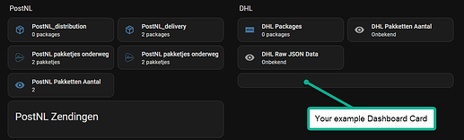

i have tried to remove some key i think i am safe leaking passwords but this what mine configuration.yaml looks like
Configuratiewaarschuwingen
Invalid config for ‘sensor’ at configuration.yaml, line 113: required key ‘platform’ not provided Invalid config for ‘sensor’ at configuration.yaml, line 126: required key ‘platform’ not provided.

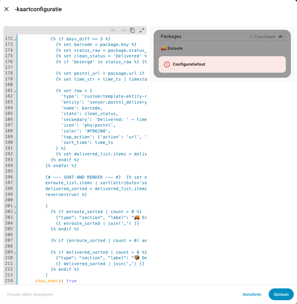

And the code for the card is as follows:
type: custom:mod-card
style: |
  ha-card {
    border-radius: 20px !important;
    background-color: rgba(10, 10, 10, 0.4) !important;
card:
  type: vertical-stack
  cards:
    - type: heading
      heading: Pakketten
      heading_style: title
      badges:
        - type: entity
          show_state: true
          show_icon: true
          entity: sensor.postnl_delivery
          icon: phu:postnl
        - type: entity
          show_state: true
          show_icon: true
          entity: sensor.dhl_packages_onderweg
          icon: phu:dhl
      card_mod:
        style: |
          ha-card {
            margin-top: 10px !important;
            margin-right: 10px !important;
            margin-left: 20px !important;
    - type: custom:auto-entities
      card:
        type: entities
        show_header_toggle: false
        card_mod:
          style: |
            ha-card {
              background: none;
              margin-top: -25px
      filter:
        template: >
          {# DHL ophalen #} {% set dhl_pakketjes =
          state_attr('sensor.dhl_packages','parcels') or [] %} {% set
          dhl_onderweg = namespace(list=[]) %} {% set dhl_recent_afgeleverd =

Almost perfect, but I am looking how to get the start-end time for PostNL
And DHL is not showing all the packages, but this is something with DHL, because on ther my.dhl… page it doesn’t show either.
(BTW, thanks to the contributors, because only did some copy-paste)

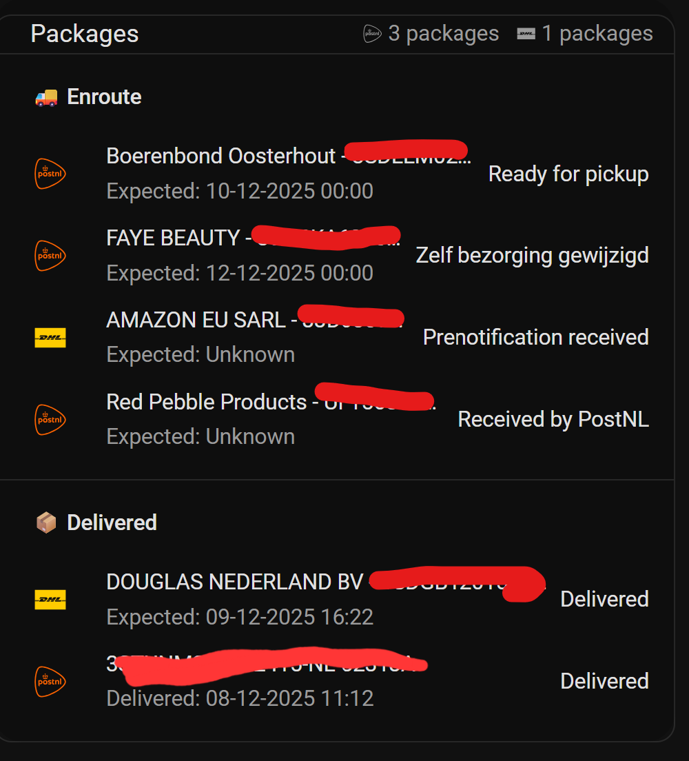

I just enjoyed this great code, and I took the initiative to translate it into English.
style: |
  ha-card {
card:
  cards:
    - type: heading
      heading: Packages
      badges:
        - type: entity
          show_state: true
          show_icon: true
          icon: phu:postnl
        - type: entity
          show_state: true
          show_icon: true
          entity: sensor.dhl_packages_ontheway
          icon: phu:dhl
      card_mod:
        style: |
          ha-card {
      card:
        type: entities
        card_mod:
          style: |
            ha-card {
              background: none;
              margin-top: -25px
      filter:
        template: >
          {# Fetch DHL data #} {% set dhl_pakketjes =
          namespace(list=[]) %} {# DHL packages #} {% for pakket in
          dhl_pakketjes %}
            {% set status = pakket.status | lower %}
            {% set tijd_raw = pakket.receivingTimeIndication.start if pakket.receivingTimeIndication.start is defined else pakket.receivingTimeIndication.moment %}
            {% set tijd_end = pakket.receivingTimeIndication.end if pakket.receivingTimeIndication.end is defined else pakket.receivingTimeIndication.moment %}
            {% set tijd = 'Unknown' %}
            {% set tijd_ts = 9999999999 %}
            {% if tijd_raw %}
              {% set tijd_ts = as_timestamp(tijd_raw) %}
              {% set tijd = tijd_ts | timestamp_custom('%d-%m-%Y %H:%M') %}
              {% if tijd_raw != tijd_end %}
                {% set tijd = tijd_ts | timestamp_custom('%d-%m-%Y %H:%M') ~ ' - ' ~ as_timestamp(tijd_end) | timestamp_custom('%H:%M') %}
              {% endif %}
            {% endif %}
            {% set naam = pakket.sender.name if pakket.sender.name else 'Unknown sender' %}
            {% set barcode = pakket.barcode %}
            {% set nette_status = pakket.status | replace('_', ' ') | lower() | capitalize() %}
            {% if nette_status == 'Prenotification received' %}
              {% set nette_status = 'Registered' %}
            {% endif %}
            {% if nette_status == 'Shipment picked up' %}
              {% set nette_status = 'Received by DHL' %}
            {% endif %}
            {% if nette_status == 'Parcel picked up at parcelshop' %}
            {% endif %}
            {% if nette_status == 'Shipment acceptance parcelshop' %}
            {% endif %}
            {% if nette_status == 'Parcel sorted at hub' %}
              {% set nette_status = 'Sorted' %}
            {% endif %}
            {% if nette_status == 'In transit' %}
              {% set nette_status = 'In transit' %}
            {% endif %}
            {% if nette_status == 'Parcel arrived at local depot' %}
              {% set nette_status = 'At local depot' %}
            {% endif %}
            {% if nette_status == 'Out for delivery' %}
              {% set nette_status = 'Out for delivery' %}
            {% endif %}
            {% if nette_status == 'Not home system intervention delivery at parcelshop' %}
              {% set nette_status = 'En route to DHL point' %}
            {% endif %}
            {% if nette_status == 'Notification for parcelshop collection has been sent' %}
              {% set nette_status = 'Ready for pickup at DHL point' %}
            {% endif %}
            {% if nette_status == 'Delivered' or nette_status == 'Delivered in mailbox' or nette_status == 'Collected at parcelshop' %}
              {% set nette_status = 'Delivered' %}
              {% set verwacht_of_bezorgd = 'Delivered' %}
            {% else %}
              {% set verwacht_of_bezorgd = 'Expected' %}
            {% endif %}
            {% set dhl_track_url = 'https://www.dhl.com/nl-en/home/tracking.html?tracking-id=' ~ barcode ~ '&submit=1' %}
            {% set row = {
              'type': 'custom:template-entity-row',
              'entity': 'sensor.dhl_packages',
              'name': '' ~ naam ~ ' - ' ~ barcode,
              'state': nette_status,
              'secondary': '' ~ verwacht_of_bezorgd ~': ' ~ tijd,
              'icon': 'phu:dhl',
              'color': '#ffcc00',
              'tap_action': {
                'action': 'url',
                'url_path': dhl_track_url
              'sort_tijd': tijd_ts
            {% if 'delivered' in status or 'collected' in status %}
              {% if pakket.receivedDaysAgo is not none and pakket.receivedDaysAgo <= 3 %}
                {% set dhl_recent_afgeleverd.list = dhl_recent_afgeleverd.list + [row] %}
              {% endif %}
            {% else %}
              {% set dhl_onderweg.list = dhl_onderweg.list + [row] %}
            {% endif %}
          {% endfor %} {# Fetch PostNL data #} {% set postnl_enroute =
          state_attr('sensor.postnl_delivery', 'enroute') or [] %} {% set
          postnl_delivered = state_attr('sensor.postnl_delivery', 'delivered')
          or [] %} {% set postnl_onderweg = namespace(list=[]) %} {% set
          postnl_recent_afgeleverd = namespace(list=[]) %}
          {# PostNL packages in transit #} {% for pakket in postnl_enroute %}
            {% set naam = pakket.name if pakket.name else 'Unknown sender' %}
            {% set barcode = pakket.key %}
            {% set nette_status = pakket.status_message | default('Status unknown') %}
            {% if 'nog niet door PostNL ontvangen of verwerkt' in nette_status %}
            {% endif %}
            {% if 'is ontvangen door PostNL' in nette_status %}
              {% set nette_status = 'Shipped' %}
            {% endif %}
            {% if 'is gesorteerd' in nette_status %}
            {% endif %}
            {% if 'is onderweg' in nette_status %}
            {% endif %}
            {% if 'Je hebt betaald' in nette_status %}
              {% set nette_status = 'Clearance fees paid' %}
            {% endif %}
            {% set tijd_raw = pakket.planned_from %}
            {% if tijd_raw %}
            {% endif %}
            {% set postnl_track_url = pakket.url if pakket.url is defined else 'https://www.postnl.nl/tracktrace' %}
            {% set row = {
              'entity': 'sensor.postnl_delivery',
              'secondary': 'Expected: ' ~ tijd,
              'icon': 'phu:postnl',
              'color': '#FB6200',
              'tap_action': {
                'action': 'url',
                'url_path': postnl_track_url
            {% set postnl_onderweg.list = postnl_onderweg.list + [row] %}
          {% endfor %}
          {# PostNL recently delivered packages (max 3 days) #} {% for pakket in
          postnl_delivered %}
            {% set tijd_raw = pakket.delivery_date %}
            {% set tijd_ts = 0 %}
            {% set dagen_verschil = 999 %}
            {% if tijd_raw %}
              {% set nu = now().timestamp() %}
              {% set dagen_verschil = (nu - tijd_ts) / 86400 %}
            {% endif %}
            {% if dagen_verschil <= 3 %}
              {% if 'Pakket is bezorgd' in nette_status %}
              {% endif %}
              {% set row = {
                'name': '' ~ barcode,
                'secondary': 'Delivered: ' ~ tijd,
                'color': '#FB6200',
                'tap_action': {
                  'action': 'url',
              {% set postnl_recent_afgeleverd.list = postnl_recent_afgeleverd.list + [row] %}
            {% endif %}
          {% endfor %}
          {# Build final list #} {% set all_onderweg_items = [] %} {% if
          dhl_onderweg.list %}
            {% set all_onderweg_items = all_onderweg_items + dhl_onderweg.list %}
          {% endif %} {% if postnl_onderweg.list %}
            {% set all_onderweg_items = all_onderweg_items + postnl_onderweg.list %}
          {% endif %} {% set all_onderweg_items_sorted = all_onderweg_items |
          sort(attribute='sort_tijd') %} {% set all_recent_afgeleverd_items = []
          %} {% if dhl_recent_afgeleverd.list %}
            {% set all_recent_afgeleverd_items = all_recent_afgeleverd_items + dhl_recent_afgeleverd.list %}
          {% endif %} {% if postnl_recent_afgeleverd.list %}
            {% set all_recent_afgeleverd_items = all_recent_afgeleverd_items + postnl_recent_afgeleverd.list %}
          {% endif %} {% set all_recent_afgeleverd_items_sorted =
          all_recent_afgeleverd_items | sort(attribute='sort_tijd',
          reverse=true) %} [
            {% if all_onderweg_items_sorted | count > 0 %}
                "type": "section",
                "label": "🚚 Enroute"
              {% if all_onderweg_items_sorted | count > 0 %}, {{ all_onderweg_items_sorted | join(',') }}{% endif %}
            {% endif %}
            {# Add a comma between sections ONLY if both exist #}
            {% if (all_onderweg_items_sorted | count > 0) and (all_recent_afgeleverd_items_sorted | count > 0) %},{% endif %}
            {% if all_recent_afgeleverd_items_sorted | count > 0 %}
                "type": "section",
                "label": "📦 Delivered"
              {% if all_recent_afgeleverd_items_sorted | count > 0 %}, {{ all_recent_afgeleverd_items_sorted | join(',') }}{% endif %}
            {% endif %}
      show_empty: true
It was fun. If you find anything wrong, please correct me.
