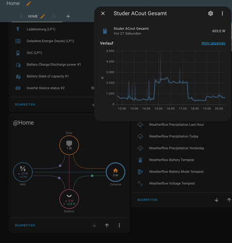

Hi, thank you for this nice implementation
have problem i didnÂŽt see home consumption - didnÂŽt find the mistake
when i click on the bubble
thank you
edit: it seems as long as home consumption < solar production - value is shown otherwise not

i combining 2 different pv systems studer-innotech based island system and huawei based grid feed with home consumption both with battery - and i made a mistake building sum entities
