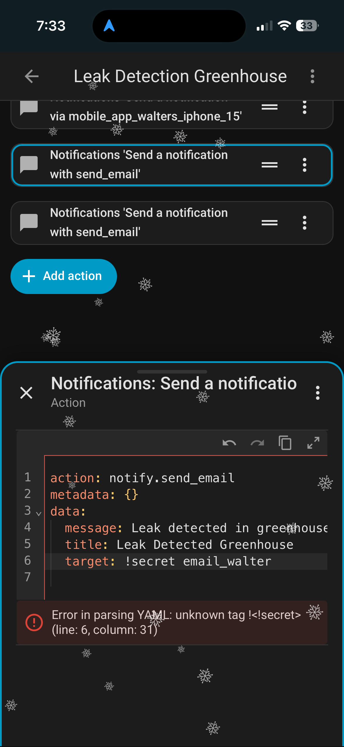

I see in the docs that the secrets file can be used to protect personal info so I’m trying to add more personal info other than just passwords but getting parsing errors in yaml.
Example-
action: notify.send_email
metadata: {}
message: Leak detected in greenhouse.
title: Leak Detected Greenhouse
target: !secret email_walter
The email address has been properly entered in secrets.yaml but when I try to use it I get this-

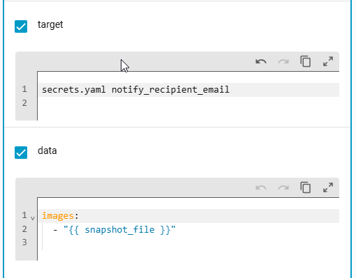

Not quite, I have been able to create it in the UI without issues.
Looks like this in YAML
  - action: notify.isp_email
    metadata: {}
      message: "waffle "
      title: "Motion Detected "
        images:
          - "{{ snapshot_file }}"
      target: secrets.yaml notify_recipient_email
The problem I encounter, the email is not sending / or possibly being excepted by the upstream MTA

That’s not how secrets are called, so that might pass some YAML syntax, but it’s not doing what you think…
Use YAML.
I chose “Edit in YAML” within the UI. Should I have edited it directly from File Editor in automations.yaml?

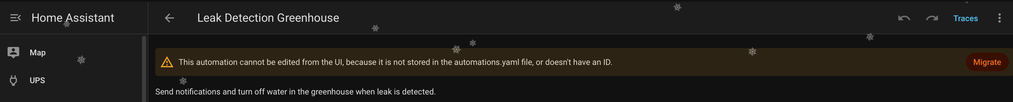

Editing with File Editor also doesn’t seem to work. Now I have an orphaned automation.
Tried testing the action using Dev Tools but that just gives the original error.
You cannot use the UI at all and use !secrets. Using YAML in the UI is still using the UI.
You have to create an automation using 100% yaml that’s not in automations.yaml in order to use secrets.
