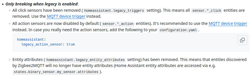

Before Z2M version 2.0, it reported a remote-control’s events (like a Philips Hue Tap dial switch) via a sensor entity (like sensor.whatever_click and sensor.whatever_action).
Starting with Z2M version 2.0, a remote-control’s events are reported via an event entity.
This breaking change was reported in the release notes for Z2M version 2.0.
A comprehensive explanation of how to convert your automations and blueprints from using the old sensor entity to the new event entity can be found here:
The alternative is to use MQTT Device Triggers instead of event entities with a State Trigger.
If you currently do not have the time to learn about the event entity (and/or to modify your automations), you can enable Z2M’s legacy_action_sensor option and it will revert to reporting a remote-control’s events via a sensor entity.

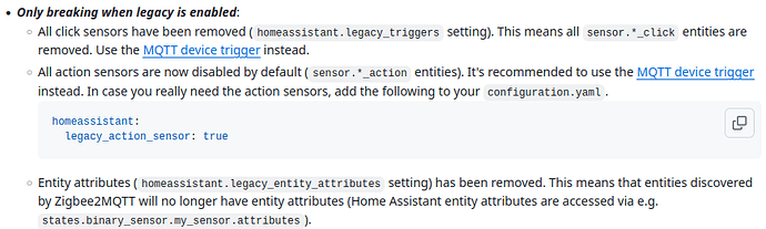

For now I would like to go for the easy way and use the action sensor. In the Zigbee2MQTT configuration.yaml the lines are defined:
homeassistant:
enabled: true
legacy_action_snsor: true
In the webUI the legacy_action_sensor option is not activated. When I try to activate I receive a error message like in the screenshot.
If you copied & pasted that directly from your yaml, you have a typo. snsor should be sensor
