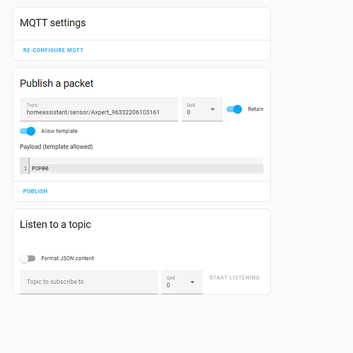

@catalinbordan Appreciate your help i have a running setup all is fine and working except the push commands iam trying to manually push one without success
