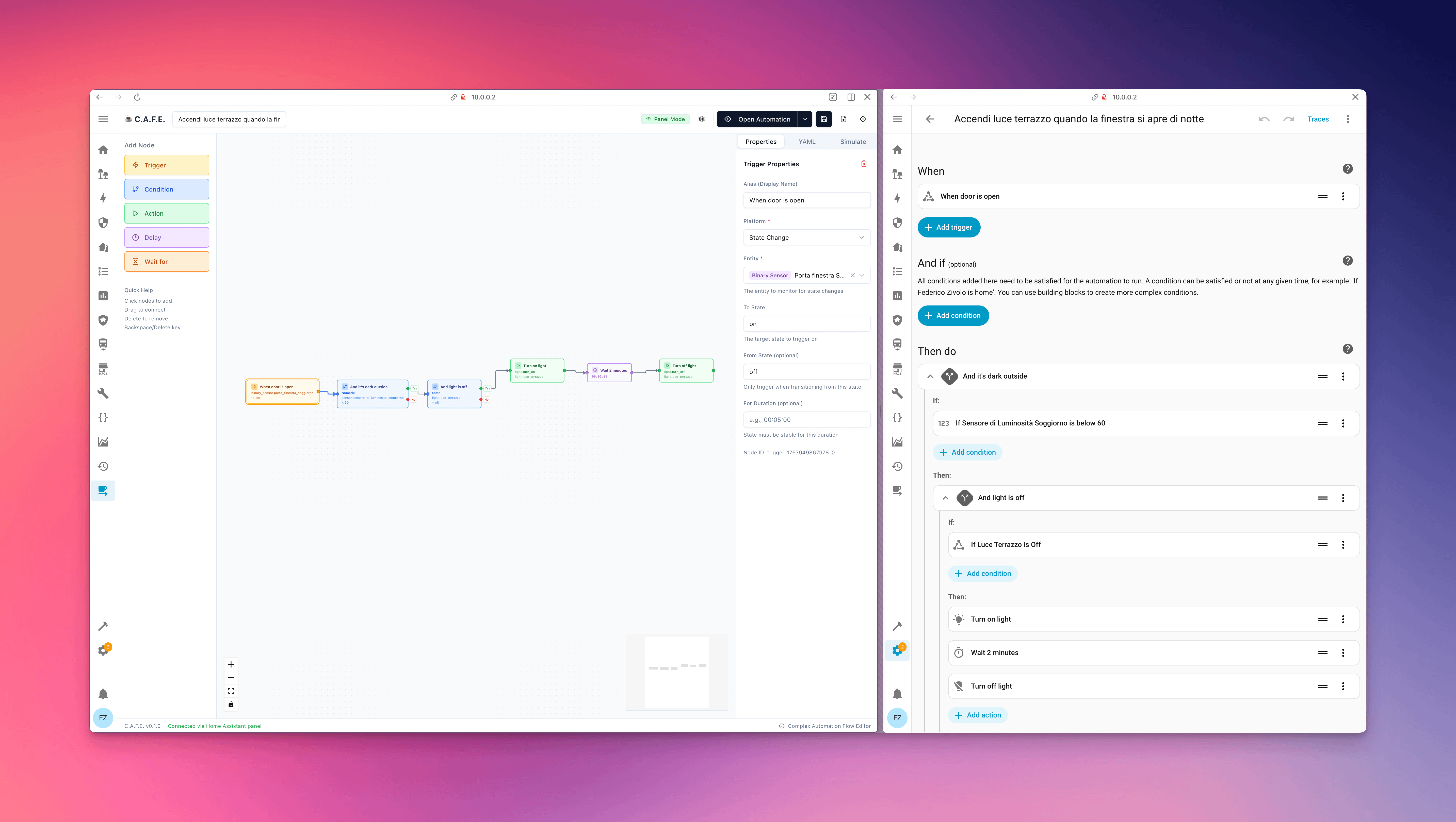

r/homeassistant - side by side comparison|750xauto

It’s a visual flow editor (built on React Flow) that lives as a panel inside your HA sidebar. The “magic” is in the transpiler: it takes your visual nodes and compiles them into 100% compliant Home Assistant native logic.

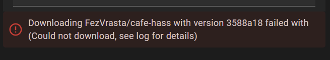

I just tried to install but there is an error downloading:
0.1.7 downloads OK though.
I could use some help to properly setup HACS :pensive:
Sorry, I can’t help you there. Was 0.1.7 on HACS? If so, then your answer is there.

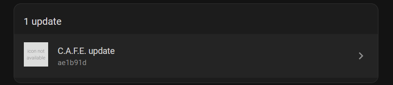

HA is offering this:

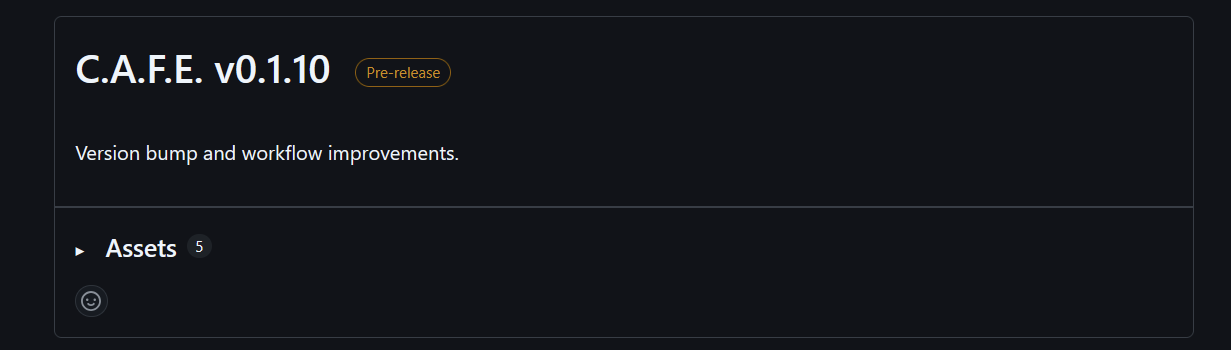

but your Github as this has the latest version:
Since the version numbers do not match, the update is failing.
Thanks, the issue was that I only had pre-releases. I just cut a normal release and it fixed the issue
Confirmed, it did fix the issue and the update installed.

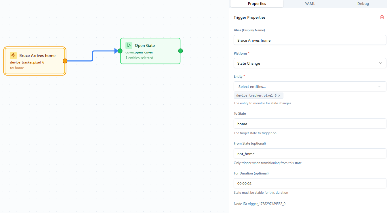

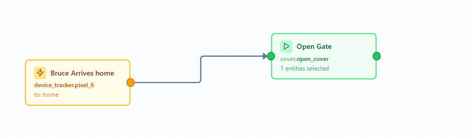

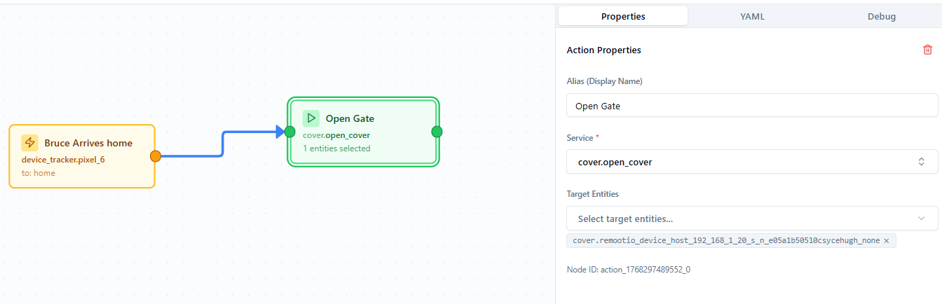

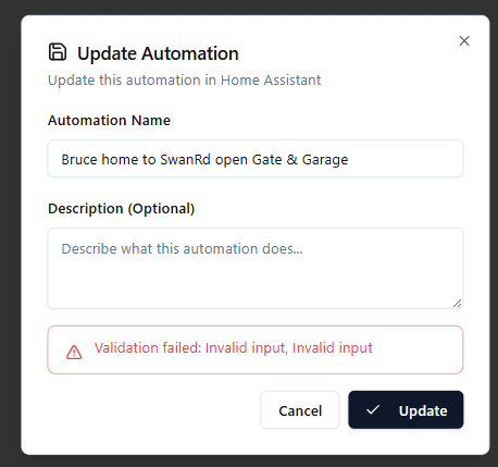

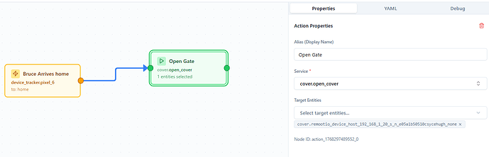

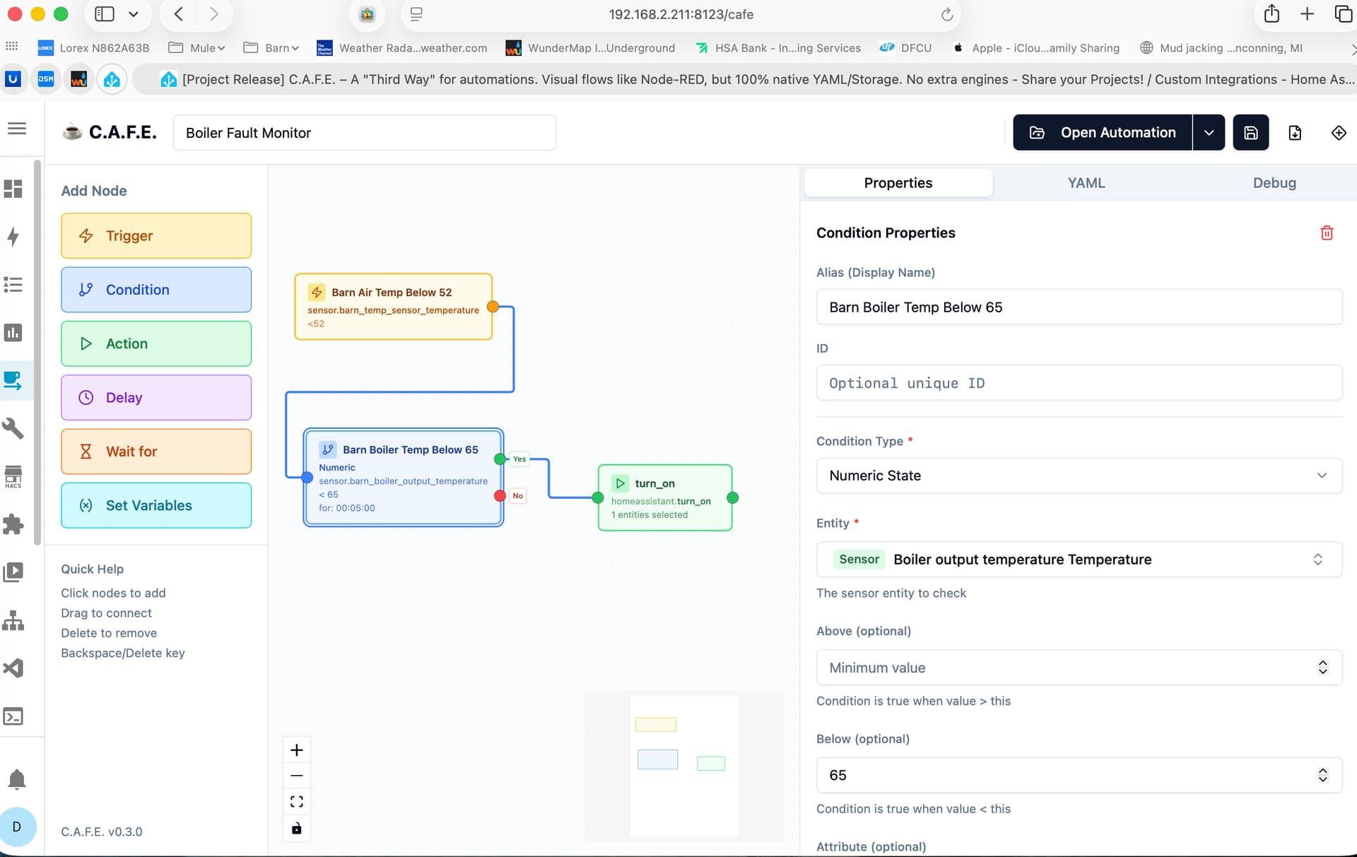

I have got stuck converting one UI automation that opens my garage door when my pixel phone changes state from not_home to home. Can I get some help on this?
Error message when trying to save
Thanks Bruce
Hi, could you provide the YAML please?

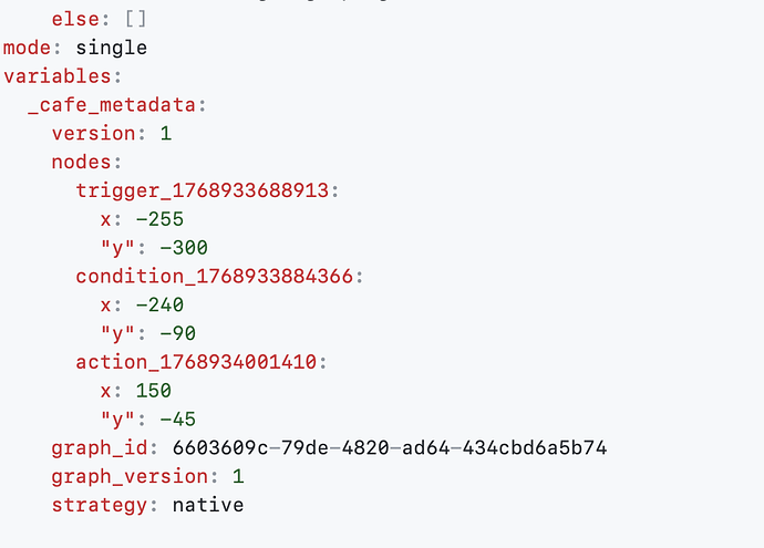

This is what i get in the Yaml tab
See if the Download button next to the Save button works, so I can try to import the script.
