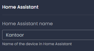

So after updating everything (HA 2023.9 and Z2M 1.33) and restarting etc etc (no error logs) I now end up with Zigbee devices that use the sensor type in the friendly name, like: Kantoor Beweging, became Kantoor Beweging Beweging. The only way to fix this is by manually changing the Home Assistant name in Zigbee2Mqtt for every sensor I have, and will connect in the future? Changing it to ‘Kantoor’ in Home Assistant name field, fixes the friendly name and allows me to still use Kantoor Beweging as Z2M name.

The issue is when you have 9 motion sensors, 13 contact sensors (9 for door and 4 window) and a few leak sensors. Basically the easiest solution is to rename all friendly names inside Z2M for HA to ‘Kantoor’. So you still have the Z2M friendly name as is, and in HA it just puts whatever behind it. Still cumbersome having to do this, but it is what it is.

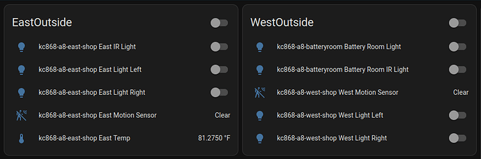

Unless I am missing something, appending the device name to the friendly name is a major user interface issue for me. I have a lot of kc868 relay boards and use ESPHome on them with MQTT. Now instead of “West Outside Lights” and “Back Fruit Trees”, I have “kc868-west West Outside Lights” and “kc868-west Back Fruit Trees”. All I need to know is what the entity is, I don’t care about the device. How do I revert this without hand editing 80+ entities in HA?
