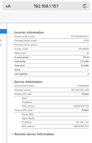

Concerning the direct connection. (the system is connected through a LAN cable!)

Screenshot of the integration
Screenshot of the direct connection to the dataloger
And HA does not want to connect (Not even talking of the sensors. It first needs to connect)
I really don’t know what to do more to get this working. First step is in getting it to connect.
There is no Firewall, no vlan stuff. HA can communicate with all the rest of my devices over IP.
I’m more and more convinced that it has something to do with the inverter (Called Collector in the JSON!) and how it is configured. Not with the integrations or API instructions. Weird thing is that I do see the typical data on the Solarman app and website.
