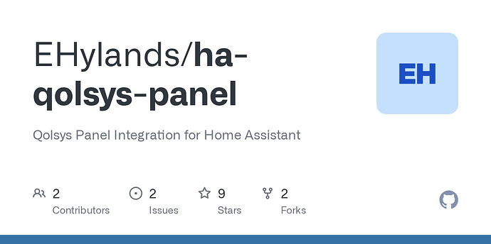

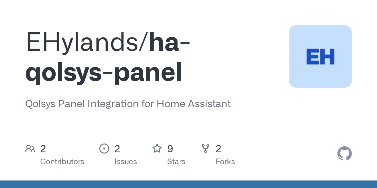

Update Dec 2025:
Be sure to also check out these new projects by Eric Hylands:
Custom integration for Qolsys Panels (such as IQ Panel 2+/4), allowing local pairing and control via Home Assistant.

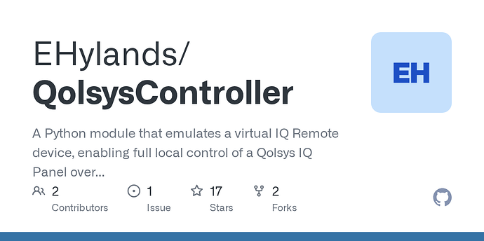

A Python module that emulates a virtual IQ Remote device, enabling full local control of a Qolsys IQ Panel over MQTT — no cloud access required.
