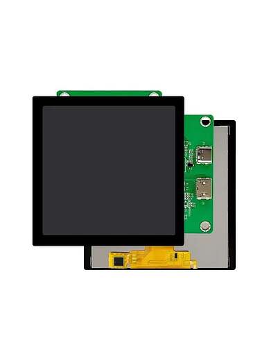

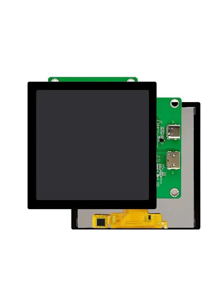

So the rough plan was to get a pi zero and one of these 4" 720x720 square touch screen displays.
