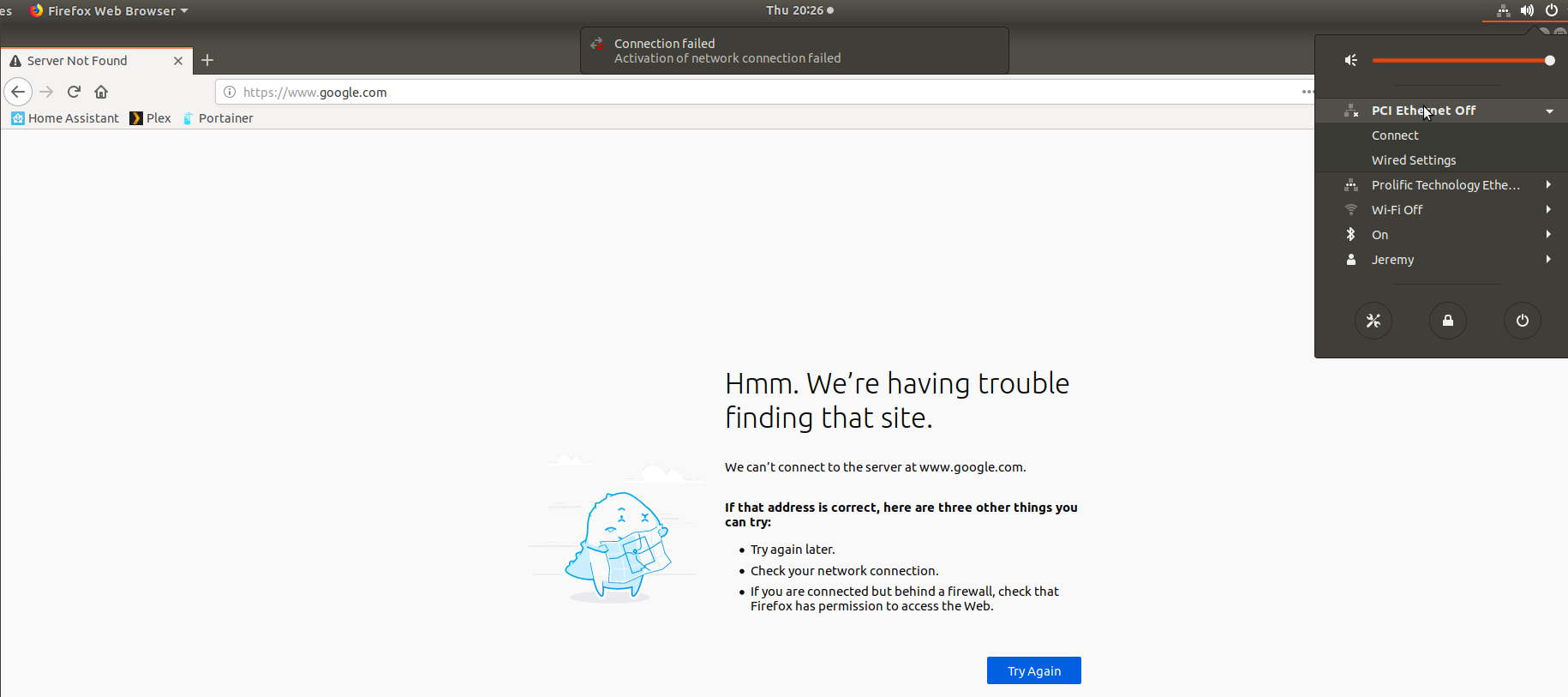

HI everyone. Thanks for the responses. I think #1 and #2 may have the same root cause, the lack of an ethernet connection at startup. This is what I am seeing:
Note the message that says “Connection failed” at the top of the screen. PCI Ethernet is Off.

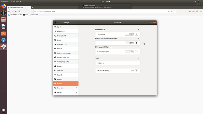

This is what the settings menu looks like. It said “Connecting” under Prolific Technology Ethernet before I took the snapshot.
After turning PCI Ethernet On, I have an internet connection right away.
Once I have a network connection I can open Portainer. I can see all the home assistant containers are running except Duck DNS is stopped. I restarted the Duck DNS, hassio supervisor and home assistant containers and everything is up and running. It’s like it is trying to use the Prolific Technology Ethernet (whatever that is) instead of PCI Ethernet. I can’t figure out how to change it.
I did change the power on option to “Last State”, but it didn’t help. It was on something like “Turn On” before. Originally the NUC wouldn’t even turn on after a power outage.

This seemed really promising. I spent a few hours messing with it and didn’t have any luck.
Eventually I disconnected the NUC from my KVM. (https://smile.amazon.com/gp/product/B011NLY5J6/ref=ppx_yo_dt_b_search_asin_title?ie=UTF8&psc=1)
Once I disconnected the NUC from the KVM the startup related network issues went away. Once I can get some kind of remote access setup, I’ll have no use for the KVM anymore, so I think I’m on the right track.
