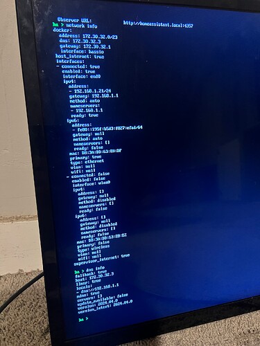

HI Tamsy, Thank you for the reply. Attached is a picture of the commands.
Any insights?
I appreciate the help

nameservers:
 -192.168.1.1
ready: true
All good on HA’s side.
Now look closer at your router (192.168.1.1). Make sure nothing outbound is blocked.
