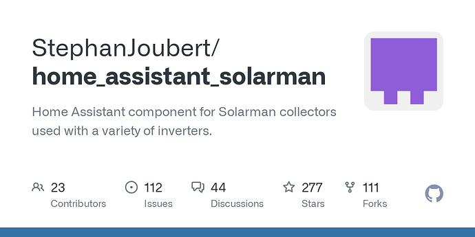

You can add it manually to your home assistant or choose another solution, like solarman
Thanks for your quick reply and I fully understand that if you don’t own an inverter that it makes no sense for you.
Do you know if the solarman data logger works with Azzurro inverter?
I got it working and can confirm the Solarman Home Assistant integration is working perfectly with Azzurro and WLAN module!
Which model of inverter do you have?
And which lookup_file are you using?

I have the AZZURRO 3PH HYD 10000 ZSS and I used the sofar_g3hyd.yaml
